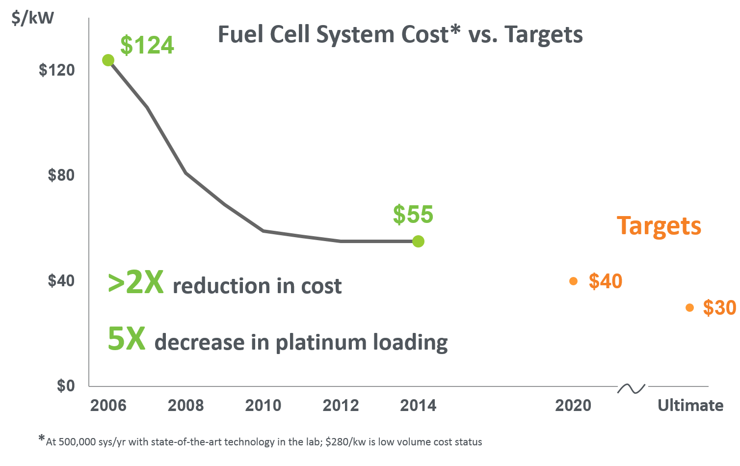

    Are you basing the replacement price from this graph?
    The cost might be lower than $55/kW, if production was up to the 500k systems a per year in fine print. A 6kW fuel cell generator runs over $27k now, G-HFCS-6kW (6kW Hydrogen Fuel Cell Power Generator). The cost to Honda is probably at the $30k point. The Mirai's would be $36k.
    The fuel cells at failing at that point. Their wattage output drops over time of use, and watt equals horsepower for the motor. The 150k mile(really 5000hrs of operation, which is about 150k miles in a car) target is the average loss to be less than 10% at that time. When a lot of fuel cells hits that failure mileage, some will be less than 10%, and some over. I think I came across the report for the 29k mile fail set, and IIRC, the worse were pushing 30%. Still, the 10% average is more than what an ICE will lose over its life.
    Some people may not notice the loss. For those that do, it's like battery capacity for BEVs, the amount of the loss could acceptable for their needs, or it may not. The problem for FCEV proponents is that this power loss isn't as well known as battery degradation by the public, and with the hurdles before FCEV adoption, reports of such losses in lower mile used cars wouldn't be well received.
    Now, in theory, these FCEVs could have been converted into PHEV or BEV models, but it probably would have been a bigger loss to Honda to do so and sell them.
