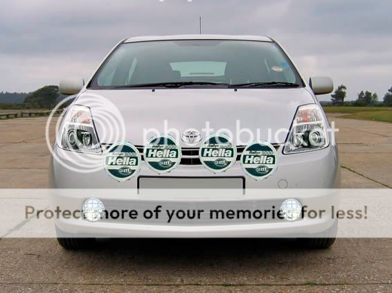

    This is your solution for better side lighting. :D
