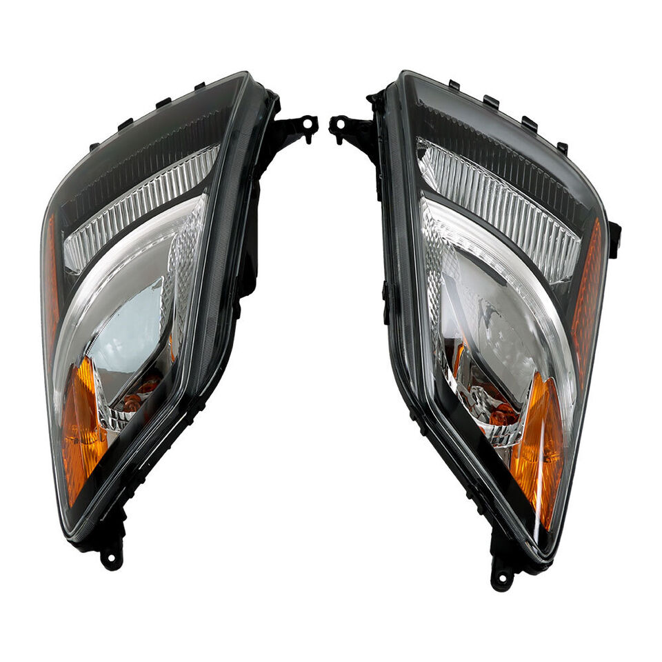

    Thinking about replacing my 2007 lights as the stock are horrible. Already have polished the plastic but wondering if there are any glass replacements available, or secondarily quality plastic housing with some type of ceramic coating or something that prevents build-up?
    thanks.
    for example, these are off ebay for $120 and most likely cheap plastic but I can't find glass ones

    You will never find glass look at the piece of plastic if you bake it in the oven for about 30 minutes and get it hot the plastic will lift right off the housing and you tell me where you're going to find a piece of glass shaped like that I would even be willing to pay a company to make me two. If I could get it done for say under $350 for two left and right I don't even know who I would go about beginning to question about this windshield makers PPG I have no clue You will not do better than the factory original housings the plastic is thick if the car was garaged and taking care of. They should still look good today and just starting to get cloudy buffing them out with the proper kit with the proper steps should yield you another 15 years of no problem If you're going to take lenses off to try and fit glass or something like that might as well go all the way and put in a small projector been done been done on several other makes too no problems It's about $80 aside for something worth your while projectors that is then you've got whole engineered system for your car Great The only problem is I don't do much night driving anymore but there's a post right here in this generation two section of a guy that just got through doing this couple of weeks ago.

    dont projectors go out/wear out really quick? can you link me to the person who worked on his headlights if you know? thanks.
