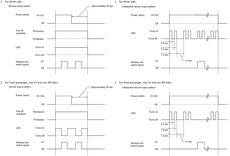

    So I was driving it tonight and dreading the thought of crouching over half the day tomorrow trying to rewire that in when I noticed the driver's window switch blinking:
    Blink Blink pause blink blink pause... Reminded me of reading OBD1 toyota codes...
    I search the web for "toyota power window switch blinking" and see a thread on priuschat where a Gen2 12v battery change caused the blinking switch. The solution in that thread was to recalibrate the auto switch by turning the car on, lowering the window half way, and then raising the window all the way up and continue holding the switch up for an additional 5 seconds.
    That didn't quite work for me so I tried a few different things and found the procedure for the gen 3:
    Turn the car on (to "ready" - accessory "on" won't work). lower the window all the way. Raise the window all the way and continue holding for 5 seconds. If it is dark and your lights are on, you'll see it stop blinking. So now my auto up/down works again as well the switch working for ~30 seconds after you turn the car off (or until someone opens a door).
    Yay for simple fixes...

  9. ChapmanF
    25,965
    16,946
    Yup ... that's how it tells you it wants to learn where up is.

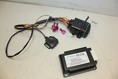

    I couldn't see, but I could sort of feel the wires and I am reasonably sure 3 of them forked off and plugged into this fake diagnostic port looking thing:
    PXL_20220428_223424643_exported_1651185384268.jpg PXL_20220428_223435400.jpg
    It was attached with self-taping screws to the very bottom of the interior panel below the steering column. The blue button is the only user-interface thing on it. "Tested 155/10" makes me think May 15, 2010? Or day 155 of 2010 (June 4th)?
    But I'm more motivated to remove it all after seeing some discoloration on the foam on the kick panel:
    It looks like a burn mark, but the wires are really greasy and have lots of gooey electrical tape residue. So it might not be a burn, but it doesn't reassure me...

  12. JahT
    JahT Member
    Dec 10, 2007
    145
    76
    Yes that part number on the sticker points toward a dealer-installed Karr alarm system (add-on box).
    xliderider and ToyXW like this.
  13. JSB_99
    JSB_99 Member
    Aug 24, 2017
    66
    48
    Houston
    The Karr alarm is exactly what i was going to say. Mine had one in it when I bought it a few months and i ripped it out. They were a money maker for Toyota Dealers.

    Mine didn't have the larger box, but there was an empty plug in the medium-sized box (the box with the blue plastic screw to adjust sensitivity) so maybe you got the other part if you agreed to buy the alarm:
    I did not have to cut or splice anything, just removing the wires worked although the connector with the red/white wires at the bottom of the picture liked to set the horn off if it jostled until I completely removed the ground wire.
