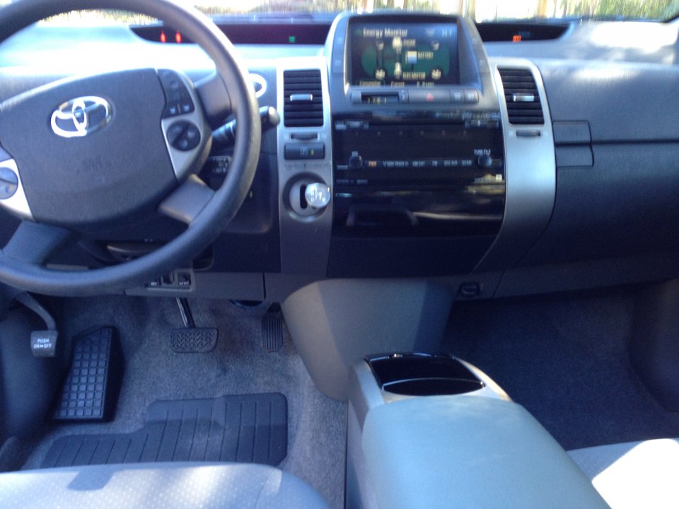

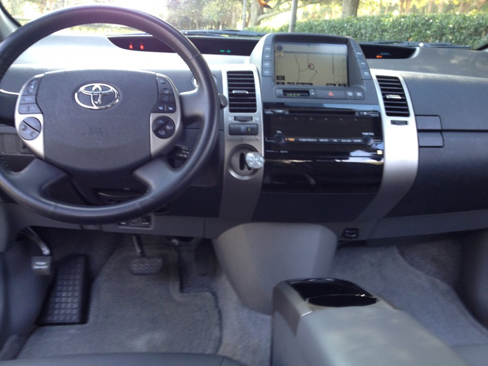

If it has the phone/map/info button cluster in the top right section of steering wheel it definately has bluetooth. It may also have navigation but to be sure look at the picture of the MFD (multi-function display). If it has 4 hard buttons on the left side and 3 on the right it has nav, if it has 2 on each side it does not. There are some cars with bluetooth(which includes the map button) that do not have navigation. Package numbers/letters change from year to year. This thread has a great breakdown of the packages by year. 2G Prius (2004-2009) Standard and Optional Equipment (Some Countries) | PriusChat
