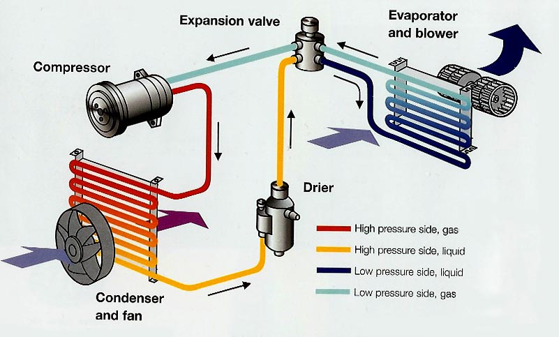

    The radiator-like part inside the dash that cools the air flowing through the HVAC system is called the "evaporator". That's because the refrigerant enters the evaporator as a liquid and leaves as a gas, cooling down dramatically in the process. It's like "canned air" - if you spray one of those cans for several seconds the can will get quite cold and can even get frost forming on its surface.
