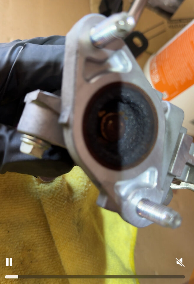

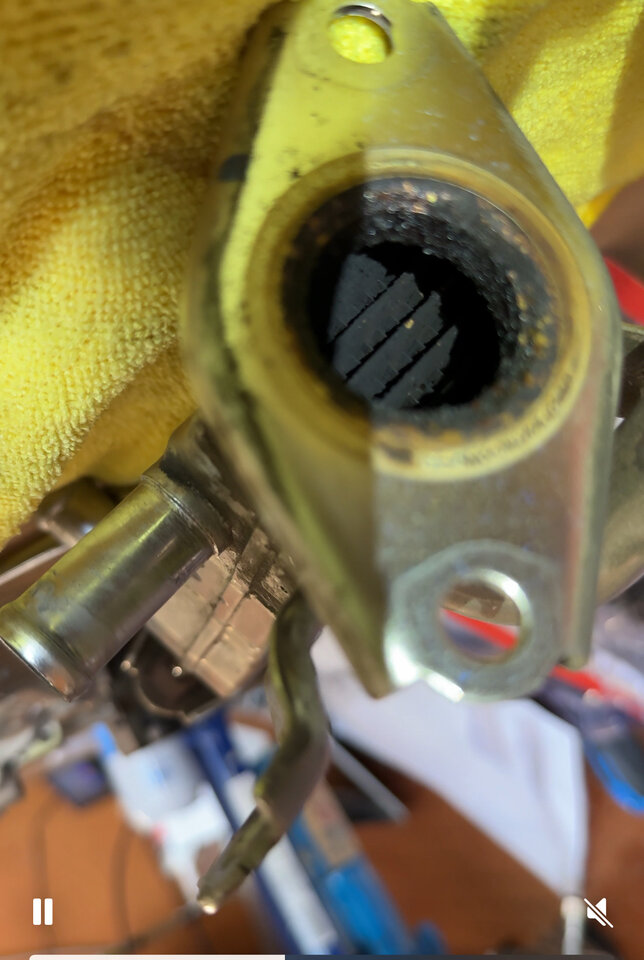

    My prius is at 128k miles
    Just got the EGR valve and cooler out -- Took me 1 month with the car sitting in the garage. I'm learning how to work on cars (i'm a hospital therapist by trade) -- none of this is easy and takes me 10x longer to do
