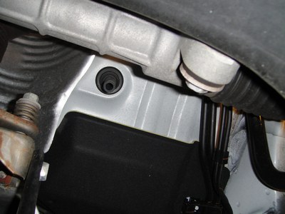

    Is this it? Re: Where exactly is the A/C drain tube?
    Is this it? Again it seems too high up and would drip on to the I-beam (not good).

    Yup thats it. Not sure why Toy did not extend that down a little and just make it a flimsier rubber like most American cars but i guess its not exposed to FOD up there.
    And I am glad its a pretty solid tube when I do the AC service. That
    spray can adapter hose that fits on that tube fits really tight inside that hose. You don't need to hold the spray tube into the hose when injecting the cleaner. handy.
    BTW since your under there see those 2 bolts on the exhaust manifold with the springs on them? My 2007 was making an odd noise in that area when the ICE was on and I could not find it so on a lark I tightened both those bolts up a tiny bit and the noise went away. I think they come loose a little with the heat/cold differences. Tighten them up just a tiny bit if they seem loose. Tiny bit.
