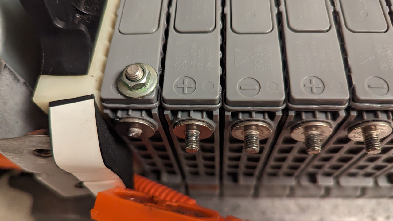

    Good Evening ~ I snapped a post using a Harbor Freight Torque wrench set to 48 inch lbs what's done is done. From what I understand trying to rebuild the post is a bad idea . Swapped modules from a 35k mile 2020 into my Oldie but goodie? Gen 2
    How would I aquire a module that would best match this rebuilt pack that is entirely harvested from a 2020? I have no conceivable way of "balancing" the pack that's why I opted for a total module replacement from a much newer pack. I am in the NY metro area.

    For completeness sake posting image of the broken post.
