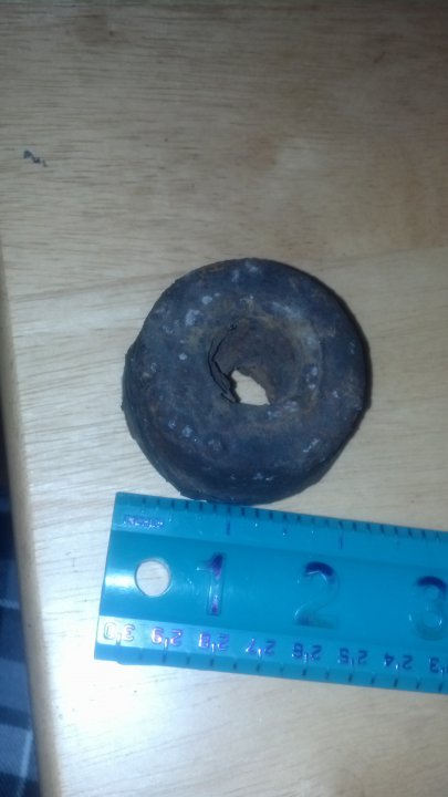

Who can Identify this mystery part?
Discussion in 'Gen 2 Prius Technical Discussion' started by mikemar, May 24, 2014.
  1. mikemar
    mikemar Junior Member
    May 1, 2010
    Mass
    prius.jpg I was under my 05 prius replacing the exhaust donut on the manifold and saw this piece stuck in the cross member. I thought it may have been road debris that got kicked up but my daughter says she hears a thunk now when she takes her foot off the gas. I'm guessing its some kind of bushing mount but I can not see anywhere where one may be missing. Any ideas?
  2. Patrick Wong
    Patrick Wong DIY Enthusiast
    Mar 8, 2008
    18,210
    6,510
    Green Valley, AZ
    I think it is more likely that a constant velocity joint in one of the halfshafts is beginning to fail.
    The piece in your photo that was stuck is probably road debris that was kicked up and lodged in the chassis.
  3. mikemar
    May 1, 2010
    Mass
    Shafts are fine. Really think it has something to do with this bushing and where it came from.

    Clunk off gas is usually inner shaft is bad. Take it to tire shop and get it inspected. Its free. Or get front wheels off car and shake the shaft real hard. Bet its sloppy.
    Another poster here lost inner shaft and it damaged his trans.
    Hope the piece shown is not off you car cause its pretty rotten. How rotten is the undercarriage?
    How many miles on the car?

    Undercarriage isn't toooo bad. It has 289,000 miles on it though.
  6. mikemar
    May 1, 2010
    Mass
    Well I jacked the car up and there doesn't seem to be any play in the axles. With the tires off the ground I can move the tire a little in each direction but not too much. I did replace the RH axle about 3 months ago and now that seems to be leaking. I may have gotten a bad axle as I didn't use a genuine $400 Toyota axle. I did notice that the whole engine did seem to rock back and forth when I moved the tire that's why I think this may be some type of engine mount that came from the back somewhere that I can't see.

    The axle has a bad boot? I the boot is compromised and grease is being flunk about that joint will not last long and in fact may be where the clunk is coming from. Not sure about engine rocking back and forth that doesn't sound right.
    Is the other axle the original axle at 289K?
  8. mikemar
    May 1, 2010
    Mass
    The axle I replaced had a bad boot. It seems that one has a little play in it so I pulled it out and getting another one under warranty seeing it's only a couple months old. I guess that's why the aftermarket axles are $100 and the Toyota axles are $400. It only takes a couple hours to change the axle so I will start with this and see if the clunk goes away. Still wondering about this part though.
