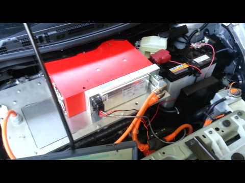

    I've seen a bunch of DIY EV's - several aftermarket Gen II Pri - several Leafs - and one Rav4-EV that have added Brusa's, in order to more than double their 240v charge
    Isn't anyone up the the challenge with their stocker Prius? You wouldn't wana get 'er done in less than 1/2 the time?

    The cool thing with Brusa is that its rate of charge doesn't have to remain a constant ... it can be programmed to slow down as full capacity nears just like quick chargers do. The Best price I've seen is 1400 bucks .... which isn't too bad considering how complex the devices' capabilities are. Well ... somebody's got to be first ... and when it happens I sure hope they post the process.
    EDIT:
    btw: For those who never saw it, and/or who may be interested in one of our own PC members who (was) IS balzie enough to potentially void his Prius warranty (and install a Brusa) look here:
    Update and technical details on my PHEV project | PriusChat
    definately not your every day run of the mill diy shade tree mechanic mods

    Wow! a PiP two years before the OEM PiP, and with twice the range! Ahhhh, Begone Thee O Envy, you Green Monster!
