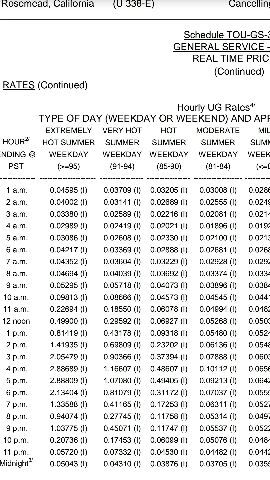

    the majority of plugins are running around the landscape of Cali .... & it seems the eia website is silent on Cali electricity average costs - which are at BEST, convoluted when it comes to commercial & industrial power rates .... different rates for power in different counties, different times of use, even season & average temps.
    That said, yes, generally commercial & industrial rates (speaking Cali) are 'better' than residential, but there's a trick. MAJOR tack-ons. From high voltage transformer fees to kV discounts, to (my favorite) peak 'demand' fees - where (in one acquaintance's county & his large business size) in addition to the per/kWh charge, SoCal edison may charge DOLLARS per kWh, sometimes based on small surges no more than 1kWh during certain times.
    One plug in owner from our SoCal group here who is also a business owner ( >250kWh/month, AND <30kWh e/hour w/no spike, ever lasting longer than ¼hr) says recently he went over his businesses' maximum peak by just ½kWh . It jacked the Co's biz for the next 3 months by 4 figures. Here's a screenshot from SCE's Rosemead corporate headquarters showing just a little of Edison's rate fluctuations;
    There are over 20 different commercial /industrial rate schedules on their website turning on flat rates, tou, general service business size, monthly quantity, & peak draw. Each document averages about 15 pages long. Then there's another whole set where you can get discounts if you allow the utility company to shut down some of your appliances. Are you a Central Valley farmer with lots of multi 100 HP water pumps? You can get a great deal if you can avoid pumping water at the whim of SCE shutting them off whenever they want .
    So yeah, they get power for just a few pennies, but there are lots of fine print. This is why you never see standalone DC quick Chargers around here, like little photo kiosks. The electric bill for a little solo company would kill you. BUT if you have a major strip mall, or multiple high-rises, constantly running elevators & other huge equipment draws, the cost of an extra 30 to 50kW's spiking may be no big deal.
