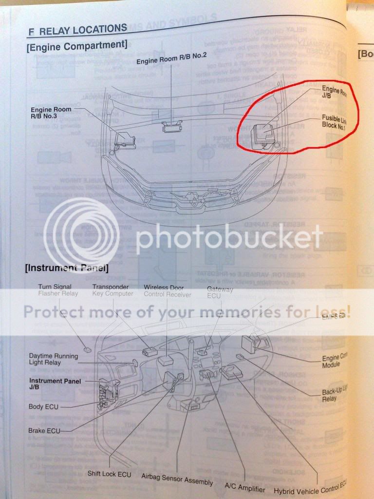

  6. ea8631
    ea8631 Member
    Oct 16, 2004
    186
    Toronto, Ontario
    2017 Prius
    Technology
    like what efusco said, here is the pics to show where is located:

  9. efusco
    efusco Moderator Emeritus
    Nov 26, 2003
    19,891
    1,194
    Nixa, MO
    The dome fuse is more than just the light, it seems to cut off all accessory power. The vehicles are shipped from Japan with the DOME fuse out and are put back in by the Port or the dealer (I'm not sure which actually) and then all things need to be reset.
    I just think that would involve fewer sparks and less hassle than disconnecting the battery cables, but either will do the job.
