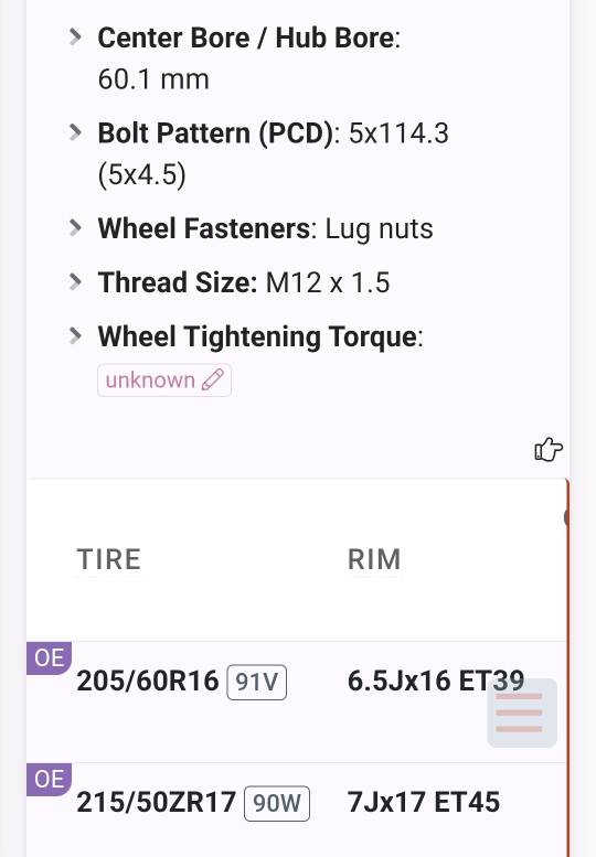

    I have a set of steel wheels/rims with winter tires for my Prius V 2013. One of the wheels got damaged and needs a replacement. The specs on the wheel says it's a 16 x 6 1/2 size. The tire size is 205/60 R16. I have two questions.
    1. Is the offset 39mm and the bolt pattern 5x114.3?
    2. Will this wheel fit?
    Vision SW60 Steel Mod 16x6.5 5x4.5" +39mm Gloss Black Wheel Rim 16" Inch | eBay
    Thanks in advance.

    Yes, it will fit. Below is the OEM specifications for the 2013 Prius V. However, you should also get a hubcentric ring to adapt the oversized 71.5mm centerbore on the wheel to the Prius V hub, which is 60.1mm. Screenshot_20250521_113858_DuckDuckGo.jpg
