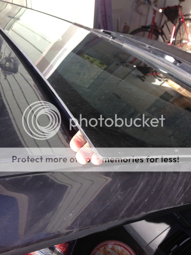

    For a year I have been wondering why I hear wind noise and battle condensation when the temperatures dip into the 40s. Last week I saw a single drop of water fall from the boundary of the headliner and the windshield and land on my wife's lap. Strange I thought, as there wasn't any condensation on the windows. I had never seen any sign of water infiltration into the cabin.
    Well, there's your problem[​IMG]
    The whole top edge and half of the sides were loose, and the glass guy said he had not seen anything like that in his 8 years. He said it looked like the person that installed it forgot to use activator on the sealant.
    Noise and condensation are no longer an issue. The windshield has been the only problem I've had.
