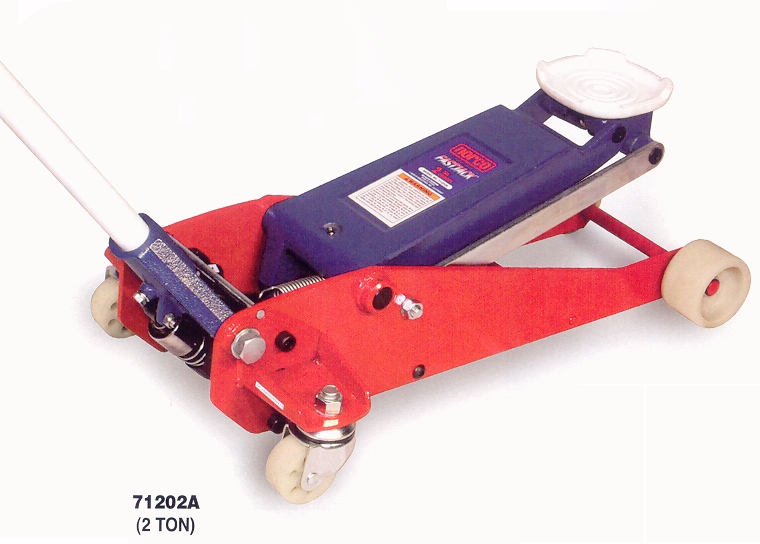

    Yep, I swap the wheels myself in the comfort of my heated attached garage. A good floor jack, actually two of them, makes the job go much easier
    http://www.hyjacks.com/n_71202x.jpg
    The better hydraulic floor jacks have a rubber adapter for the saddle that fits the jack point on the car, so you won't damage the unitbody. A small piece of 2x4 does the same job
    Use a proper 6 point socket to prevent damaging the lugnuts. Loosen the lugnuts a bit with the car still firmly on the floor. You want to do this with the brakes cool, otherwise the front rotors are easier to warp
    Now, jack up one side at a time. I suppose you could just use a single jack, and change just one wheel at a time, but I find it more efficient to use two jacks: two jacks also make tire rotation a breeze
