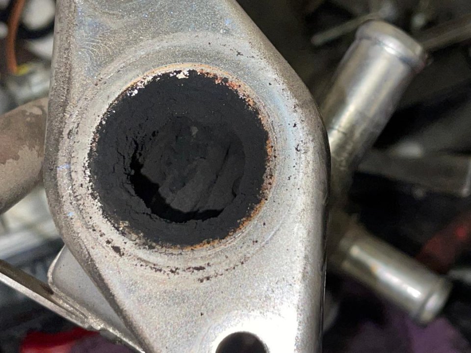

    2010 Prius with 235k miles on it. Likely 2nd or 3rd engine already and never ever cleaned the EGR system. Lo and Behold..another head gasket and time for a new engine (again). You will never see a more dirty EGR cooler and valve in your lifetime. The plunger was completely stuck like concrete and had ZERO flow through that cooler. With all the info online, I can't believe people still let this happen. I feel like eating oreo cookies now.

    OP’s pic likely used auto-exposure, which unfortunately stops down to accomodate the shiny steel flange. I’ve tried to boost it a little:

    They reliably choke up with carbon, about 25% per 50k miles. I’d suspect the rate accelerates too, as the build-up accumulates.

    It accelerates exponentially when a car is burning oil..
