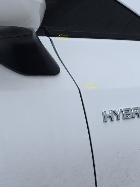

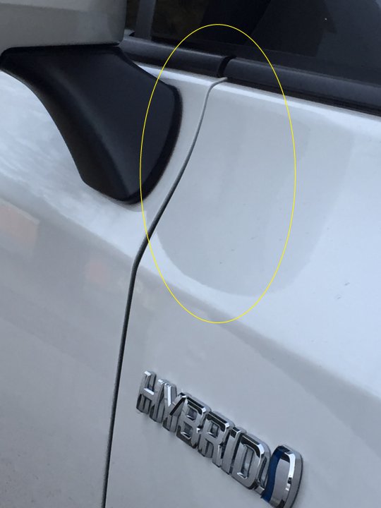

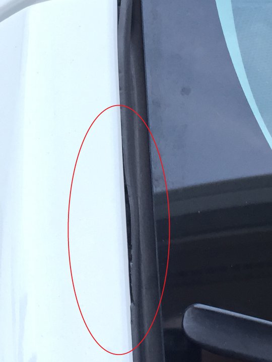

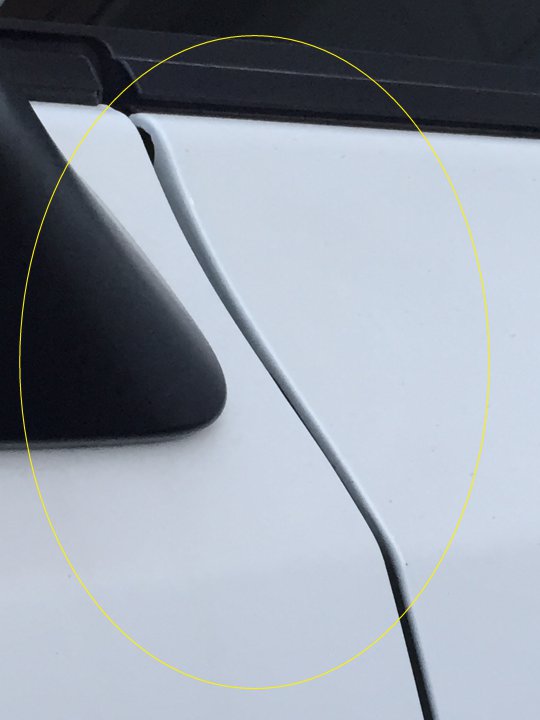

    Am I being too picky?
    I realize i have a v (lowercase v for the Prius v wagon) p.
    Right Fender and Door was replaced after rubbing a light pole. In my opinion, the fender and door don't meet together right. At certain angles when you look at the car, the gaps look wrong. I've circled or arrowed the areas to help you see what I'm talking about.
    Too picky? The repair was over $3,000. Insurance covered most of it, but they may get back at me with higher rates later :)
    Also, there is a piece of rubber trim they destroyed during the process. I am going to make sure they replace that.

    that is not flush and that is not even so until it's both continue to bug them your insurance may have paid for it but the point is the work should be done correctly until you are happythey'll tell you any excuse in the book but until you're 100% happy keep doing it until

    Did they use OEM or aftermarket parts? Aftermarket parts generally don't match up perfectly. I had a similar complaint about some repair work that was done to my Prius, but my cousin that works at a body shop said its normal and that most people just don't notice.
    Are you sure that the gap wasn't that way before? I would stop by the dealer and double check.

    I have a photo of the car prior to the accident and it wasn't there before. I think they said they used OEM parts as aftermarket wasn't available.

    Worst body work I have ever seen! Did you go to a toyota/insurance approved bodyshop?
    If the answer is yes, they should be removed from the approved list!
    Just crap workmanship!

    Where have you been? I've seen much worse! But I do agree, poor workmanship.

    The last time we had bodywork involving door replacement they never got it right. The first go was terrible. The next attempt was marginally better. I finally got involved, got it a bit better. But the doors on that car are still a little reluctant to latch properly. Door alignment is tough. But yeah, pros should be doing better.

    +1 on piss poor attention to detail. Can only imagine how much worse it looks in person.
    Perhaps take a picture of a flawless Prius vagon on the dealer lot, using a centimeter ruler on the same areas as your repaired car. This will be proof of how bad the job was done. Then go to your fixed car w/ the mgr so he can see how bad the gaps are. You could even use the undamaged side as a reference too.
