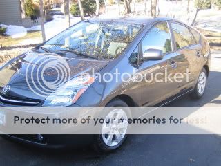

    I bought my new Prius about 1.5 weeks ago. http://priuschat.com/forums/newbie-forum/44417-just-picked-up-my-08-metallic-grey-yesterday.html I've put on about 500 miles.
    I inquired below about how to wax my new baby. http://priuschat.com/forums/care-ma...44466-newbie-gentle-how-do-i-wax-my-baby.html
    I'm a novice at all of this (in my thread inquiring about wax, one person asked if I'd looked at the "detailing" sticky on this forum...well, if I had known that "detailing meant cleaning etc. the car, I might have. :blush:
    After reading all kinds of threads on this forum, I decided to give Zaino a try. So, I ordered it. Today I washed the Prius (metallic grey), and then used Mother's claybar on it (a first for me - I hadn't even known that such a thing existed). It was pretty easy.
    After the claybar, I used Zaino Z2 pro (with the activator). Each coat (I did 3 coats - used 1 oz of the Z2) was followed by Z6. And a beer.
    The process took me about 4 hours total on my car.
    Check out the pics. I have never had such a gorgeous shiny car. I'm thrilled! I put the pics below - I originally had links instead of the pics posted, and just learned how to post the pics. Scroll down about 4 posts for the pics - sorry.
    p.s. I also used the 303 protectant on the vinyl in the car, and love the look of that, too. It looks much richer (but not gross shiny).
    I love my new car. :love:

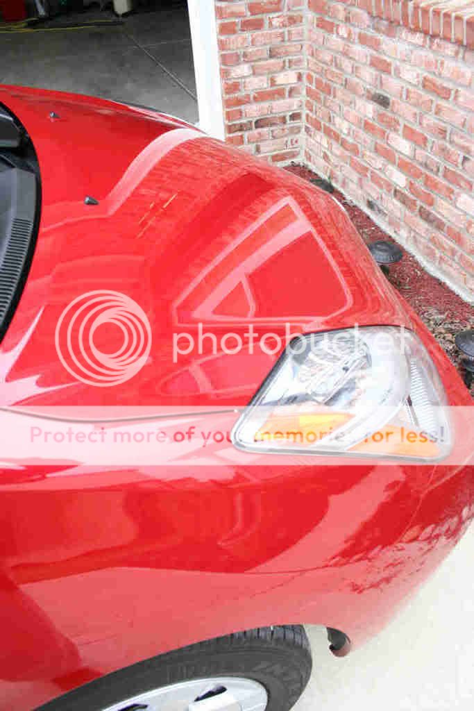

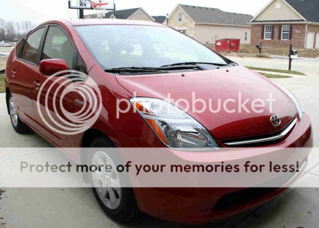

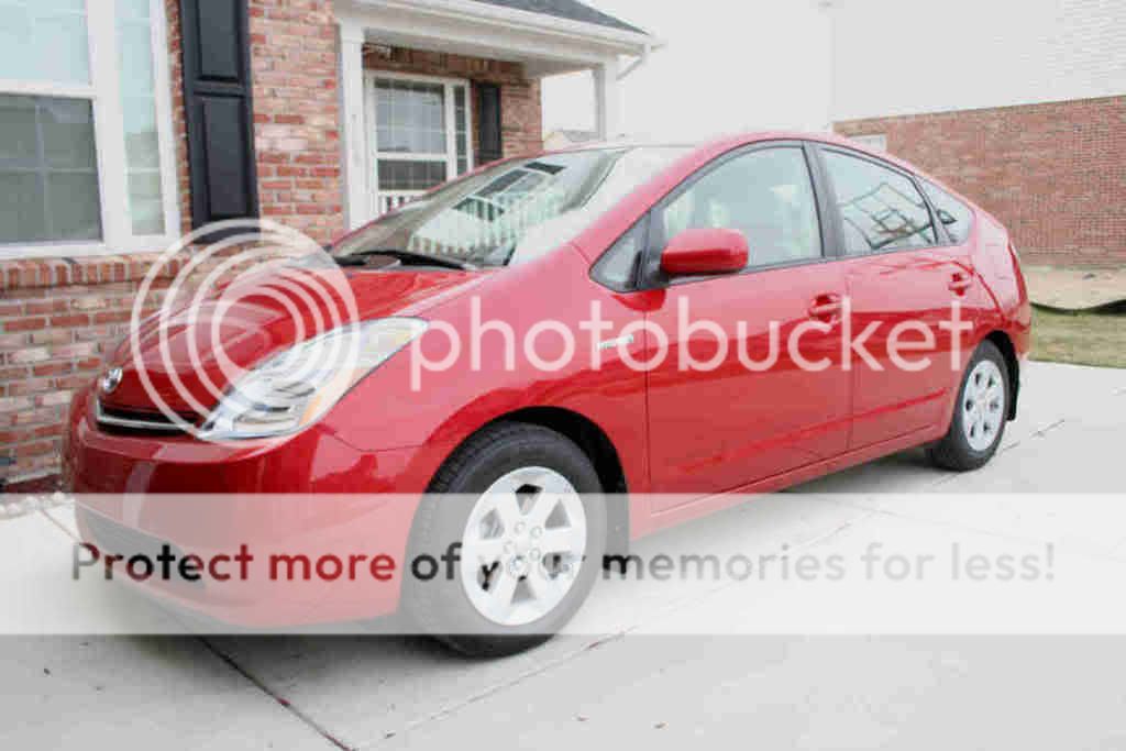

    I've read many posts on the topic of car care. As promised, I tooksome photos of my '08 Prius to show the results after applying the bestf inish protector made.
    I've used Zaino Products for years with absolute delight and have never been disappointed. A little time and a little money result in the best looking, best protected finish possible.
    The method to my madness is:
    1) Wash vehicle with Dawn detergent, rinse and dry.
    2) Use Zaino claybar as directed to remove surface contaminants (they're on new carsas well as older vehicles). It's sort of like using a defoliant on your face to clean the pores.
    3) Apply Z2 for new cars or Z5 (I use both) for slightly blemished (carwash swirl marks, etc.) cars. Add ZFX to the Z2 or Z5 for excellent results.
    4) Let dry and wipe off with 100% cotton towel made in USA (Fieldcrest or Cannon). Other types of towels may scratch the clearcoat. The use of microfiber is still questionable. I only use it on my windows.
    5) Apply Z6 detail spray sparingly, using one cotton towel to spread around the Z6 and another to dry it.
    6) Apply Z2 or Z5 again (this can be done if mixed with ZFX hardener right after applying Z2 or Z5 prior - if no ZFX hardener is used, you might have to wait a few hours before applying).
    7) Apply Z6 detail spray sparingly, using one cotton towel to spread around the Z6 and another to dry it.
    8)VERY sparingly apply Z-CS (clear sealant). Over use could result in a hazy or irridescant surface (It happened to me last month and I had to buff with Z6 to remove the streaking). Let dry.
    9) Apply Z8 (Grand Finale spray).
    After the first Zaino treatment, following applications are quick and easy. You should only have to re-apply Zaino1x/year. I choose to put on two coats twice per year. I also use Z7wash to clean my car. If it's not horribly dirty, I use Z6 to clean it(keep a bottle in the car in decent weather with a couple cotton towelsin order to spot clean if needed) - sort of like dry cleaning your car.I apply Z8 every 3 months.

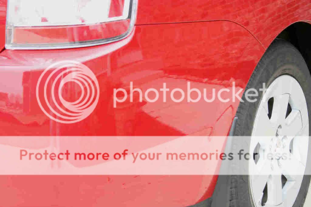

    Ok, I think I got it right this time. I apologize for my f*** ups. Hopefully, you can see the true details and awesome shine. Now, for that beer!
    Erick
    [​IMG][​IMG]
