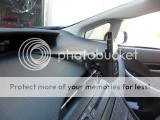

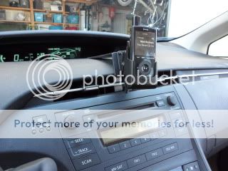

    Its supper easy, the panels just pop out, running the antenna wire to the back was fast and easy too.[​IMG]
    I also wired in the Radar Detector.

    Where did you get mounting bracket? Where did you route the wires. This look very professional

    We didnt want to activate the XM in the factory radio because we use our portable xm unit for our house/2 cars/walking/biking. Like i said, install was a snap, the dash justs snaps together and apart, no screws. I spliced into a hot wire behind the lower glove box and put in a 2 plug cigaret lighter unit. One for the xm step down plug and the other for the radar detector. Wife and I hate looking at wires. So nothing is exposed, and none of the factory power outlets are used. That cool xm mount i found at Proclipusa.com .
