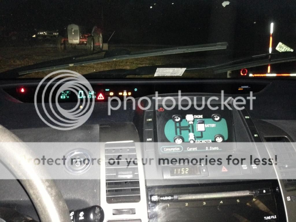

    Here is a picture from last night when the car was running. The car was in "D" and ICE was running when I took this picture....look at the dash board!

    Position nag is the ECU is not receiving rotational positioning info from that circuit via your wiring
    You repaired and is now throwing a DTC.
    The car will not drive with that DTC.
    You are throwing the red triangle master caution alarm also so the car is very unhappy.

    You have the hybrid turtle on the MFD too.
    Quit messing with it and get the codes pulled.

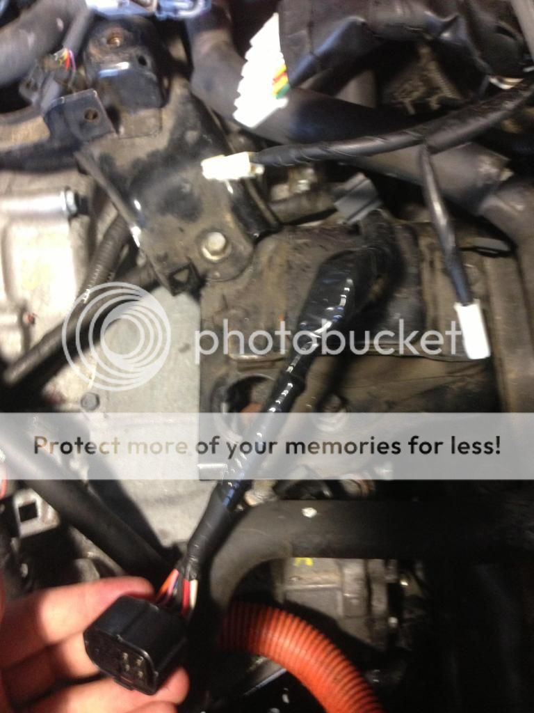

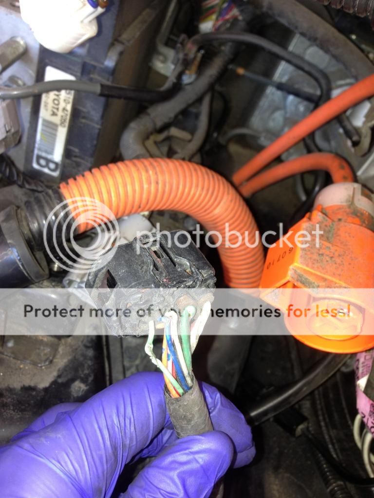

    I don't remember if I have posted these pics here, but here is the plug that I smashed when installing the trans.
    So I got another plug off of a parts car and soldered it in
    Could I have fried something by soldering?

    I'm not sure why you are asking about the inverter. Having taken those photos, you know what steps you had to take to gain access to the transaxle wiring harness socket.
    Use your ohmmeter to check the resistance across the various transaxle socket pins per the repair manual. If that is good, then use the ohmmeter to check the wiring connections between the mating wiring harness socket, and the hybrid vehicle ECU. You may have to run an extension wire for this testing. Use the ohmmeter to determine the resistance of any extensions, so you can subtract that from the reading.
    If you did not disconnect the wiring harness from the hybrid vehicle ECU before soldering, it is possible that a static charge may have been passed to the ECU which would not be helpful to the ECU's health. Before you decide that you destroyed the HV ECU, first verify the other components.

    Well your wiring job is going to have to be redone anyway as you used heat shrink tubing but never shrank them and there a little short. That wont last long no matter how much tape you use over it in an under the hood environment. Use a Western Union splice and corrosion protection applied to the joint after solder and extra long hst.
    I see the colors aren't matching either or may be the photo. Was the color code wrong on the donor plug? If so double check the color code transfer and more importantly check that the physical pins in the plug are the same they be slightly different but look the same at a glance if not identical plug.
    That's the resolver plug alright right back to the HVECU as Pat says. The HVECU is located behind the glove box on the fender.
    Its right next to the Engine ECU. The HVECU is on the right fender side.
