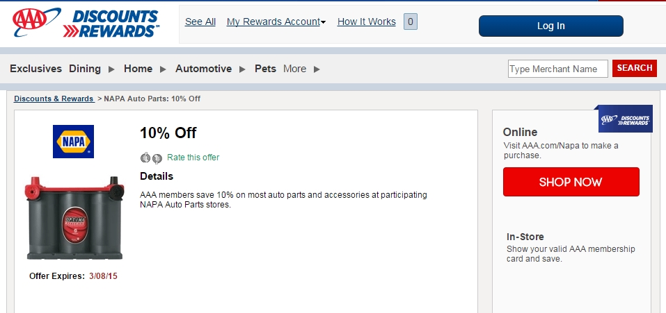

  17. JimN
    JimN Let the games begin!
    Nov 26, 2006
    7,028
    1,116
    South Jersey
    From MidAtlantic AAA:
