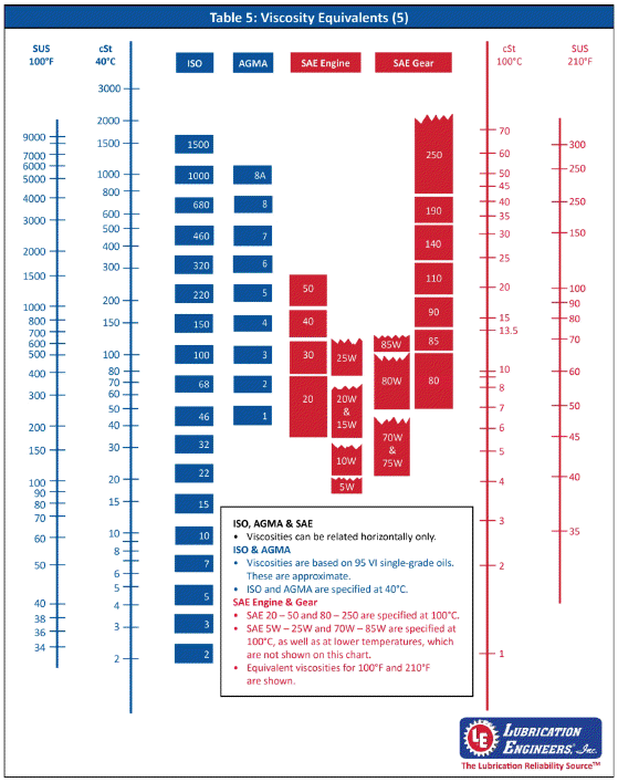

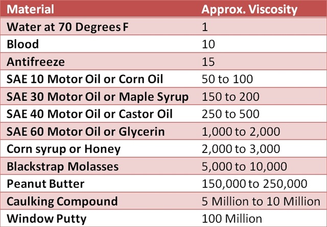

    Here is a brief lesson on oil viscosities.
    First, the viscosity of water is higher than zero.
    Second, the Xw-XX number on the label we are discussing is just the viscosity rating, and is not the actual, measured viscosity of the oil. Each rating number refers to a range of viscosities.
    A reason for having these ratings is seen in the overlap of gear and motor oil in the chart. An example bottle of each can have the same viscosity, but they are formulated for different jobs with different temperature resistance and additives. If they had the actual viscosity on the label, they might accidently be used in the wrong place.
    Finally, here is a chart showing how the viscosity changes with temperature, and why you shouldn't use straight weight oils in a car engine.
    You can find the actual viscosities for a motor oil at the manufacturer's site. The tests for cold and hot viscosity are done at 40C and 100C.
