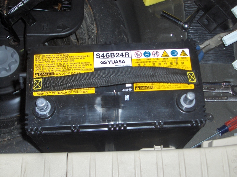

    The default batteries have warnings about charging above 3.5A or 4.2A rate. (see yellow sticker)
    I assume this would lead to venting and damaging the battery as they are lower current and not the standard CCA type batteries. You should replace with one of these low ESR audio batteries that are rated for over 900 CCA and similar 30 to 50 Ah.
    I would hazard to say getting more than 50watts and the battery won't last long if it is even capable.
    Considering the voltage drop I'm measuring on one of these with under an amp draw, I think the battery just can't put out that kind of current to get to 100W without the voltage dropping off.. I guess it is kind of like a high ESR.
    I suppose what you can do is hook up the inverter to the battery and after a full charge, (or a battery charger and start it at the same 12.6V or whatever) plot the voltage after 1 min at 10A load, 20A, 30A load and you will see the ESR and what the battery can handle. I would just replace with low ESR one as the GS / Panasonic seem to be just in there for handling 10 years of constant charging with very little load other than constant under 50mA draw.
    [EDIT]
    (not sure the different rating, maybe a japanese thing. makes sense the model number is the Ah rating)
    http://gyb.gs-yuasa.com/product/carbattery/general.html
    if you look under HJ.. I think in Japan they only rate the charging current and Ah rating.
    NHW20 - HJ-S46B24R 36Ah (238mm 128mm 202mm 227mm) 13.0kg 4.2A Toyota Hybrid

    I looked up the specs of the Odyssey 925MJ and this seems close if the reserve capacity means 35A for 40 mins and the CCA scale with the Odyssey specs. I guess it depends how short the battery only time is and if the voltage drops so low the ECU throws a code while trying to get to READY.
