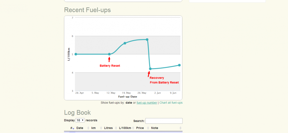

    I posted another thread concerning using the 5W-40 oil for the prius and at the same day of the oil change i reset my car by disconnecting the 12 v battery for 10min or more to check and see what happens and if the car Really accommodates the engine coefficients and correction factors to my driving habits.
    My first impression i thought that the car's MPGs went down because of the oil change from 0W-20 to 5W-40 but after keeping the same oil i saw this trend in my gas milage (attached)
    I am starting to think that this car really learns and adjusts for driving habits.
    Just thought i would share this if anyone is interested.

    your ltft (long term fuel trims) have to be re-learned.
    that should take between 50 & 100 miles, other than that there is not much to 'learn' for the car/
