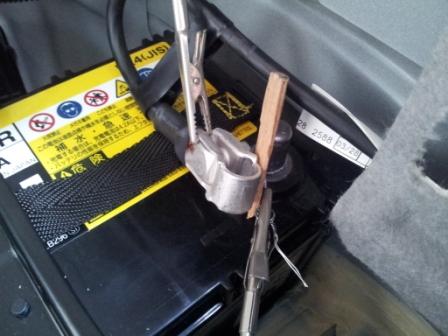

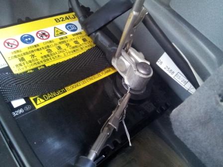

    In order not to reset the computers and loose all data while connecting the multimeter for these tests, I have tighten a conductive wire around the negative post, under the cable shoe when connected, connected the meter to both the post and the shoe before separating them:
    Before separation:
    After separation:

    Didn't check this.
    I was too afraid to make further experiments (involving slamming the doors...) and loose contact (the tiny clamps...), now that I have more confidence I may try more things.
