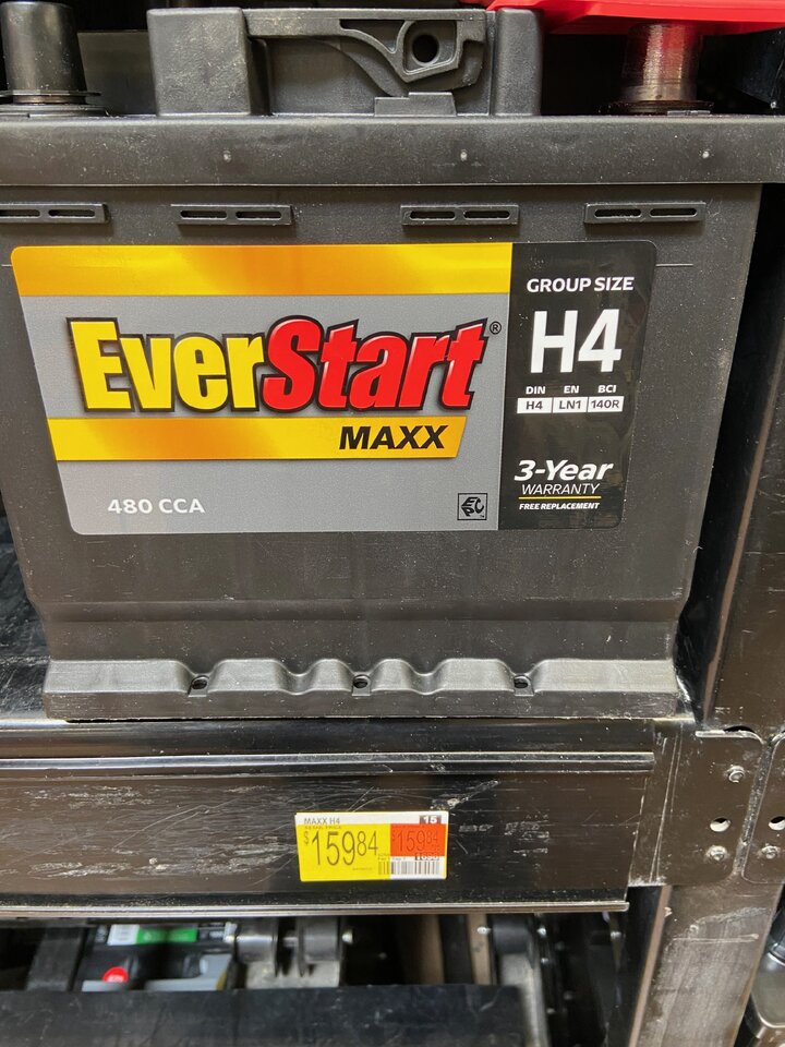

    Batteries age out. This is a direct replacement from Walmart. No brainer.
