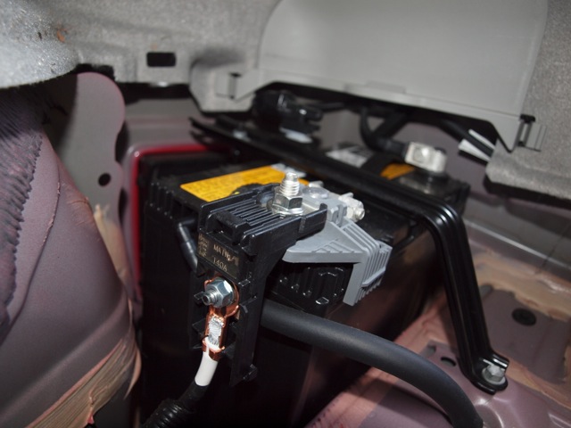

    The connection point I recommend for larger loads back by the battery is this one right here, over the side of the 12v battery terminal:
    That puts your tap on the protected side of the 140 amp "MAIN" fuse that is built into that terminal.
    It is still up to you to supply a smaller fuse (or some smaller fuses) appropriate to the wiring and accessory (or accessories) you're adding.

    In the photo back in #7, the fuse-protected connection stud is the one down over the side of the battery, that has a cable attached to it.
    I just had my tap wire terminate in another ring terminal of that size, removed that nut, and added my wire there and put the nut back on over both. (One disconnects the battery ground terminal before doing such things, of course.)
