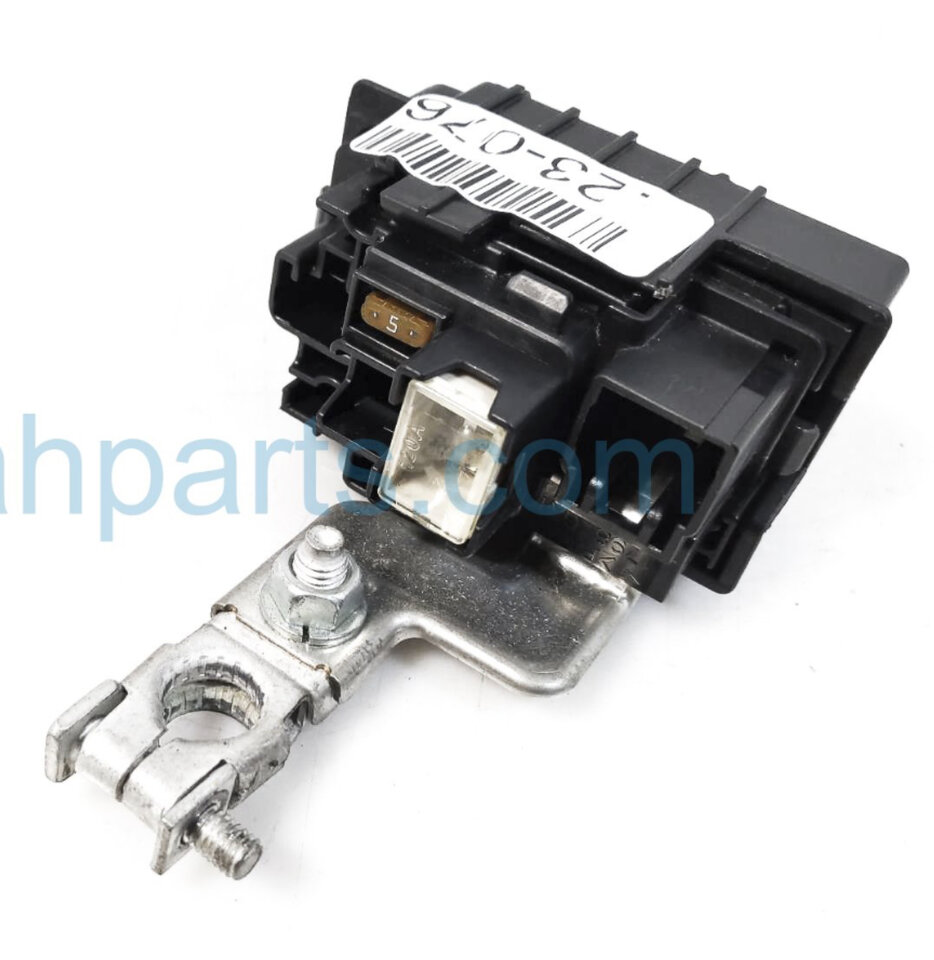

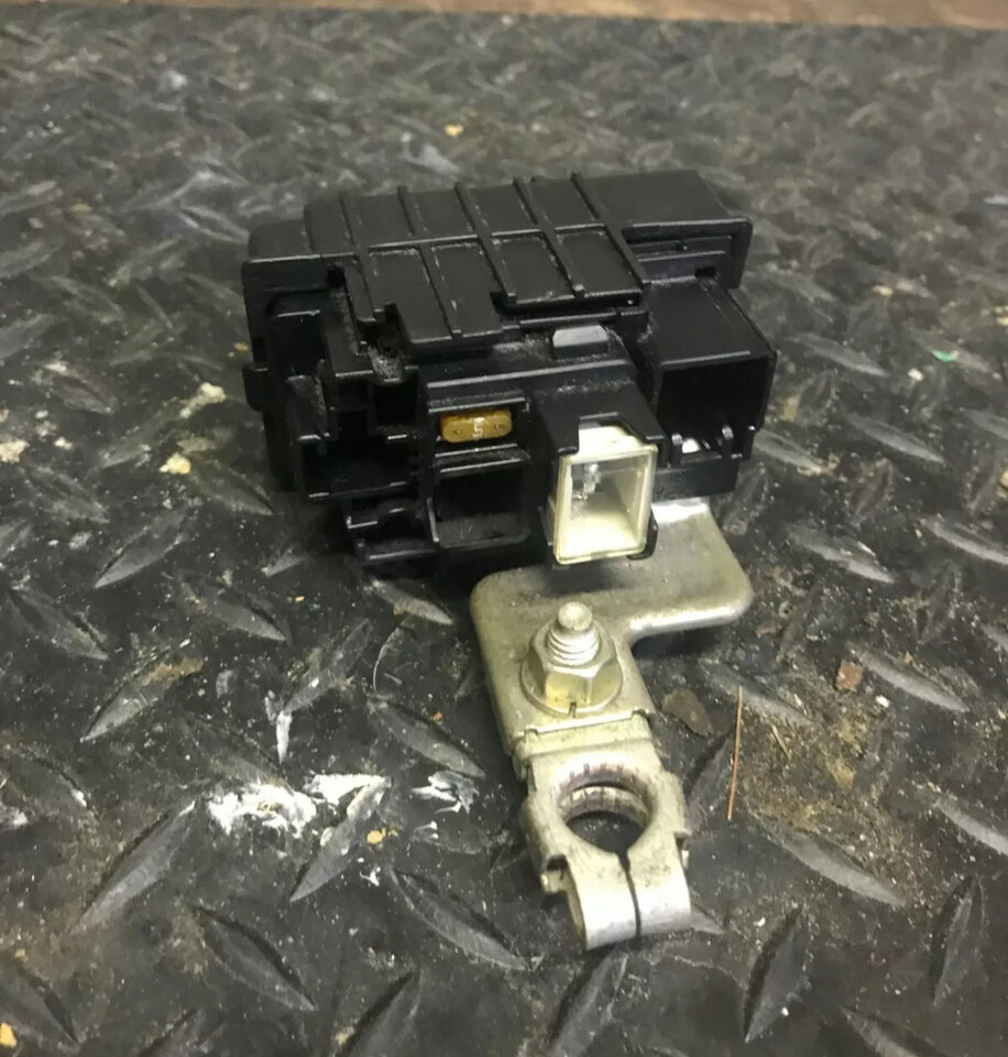

    I would look at the 120a fusible link hanging off the battery

    Thank you for the suggestion and the pics. I did look at that and it seems intact. I assume the white housing for the link is supposed to come out of the black housing? I couldn't get it out to check continuity, but I did probe where the heavy wire exits the black housing and did find 13v. 120A seems pretty big considering it's not operating a starter.

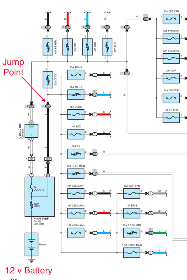

    Where is that jump point indicated on your schematic? I was trying to find where that heavy wire from the rear goes before it gets to the fuse box.

    The jump point is in the engine fuse box. To check the fusible link take it out of the circuit. If you can't get continuity it is blown. It is as simple as the drawing shows it.
    Voltage can lie because you have the 5 amp monitoring circuit.
    It is rated high because the battery could be charged at a very high rate for a short time.
    You replace the whole thing.

    The 120 amp fuse link has blade terminals that are secured with small bolts. The sides of the black housing unclip and fold out for access to the bolts so you can replace it.
    This photo (from a gen 1, where it's very similar) wasn't taken just to show that, but it does happen to show one side folded open to see where the small bolt is on that side (that's how the added red cable in the photo got attached). There's a bolt just like it on the other side, of course.
