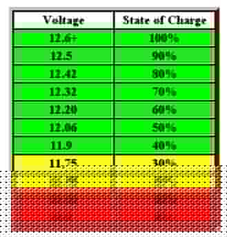

    Checked my values this morning:
    12.1
    11.9
    14.0
    Thoughts?
    MPG has seemed low, but also has been cold lately (30's) and my commute has changed from 25 miles to 8. Mostly stop lights / country roads. Getting 38-39 the past three fill ups.
    Any input is appreciated.
    Thanks!

    Ok, here is my .02 worth. It is based on my experience with our Prius and the 12 volt battery. IMO your battery is not FINE. It is borderline and weak. Yes, voltages do tend to drop as the temp drops. However, the voltages that the OP called out are definitely lower than a new fully charged battery would be at the temps the OP mentioned.
    The OP may be lucky and make it through the winter with no problems. Or the OP may find one particular cold morning that when he or she goes to start the Prius the red triangle will momentarily light. Once that starts happening, it is only a matter of time before the battery will be needing jump starts. Jump starts are a whole different issue with the Prius and if not done right, can cause a four digit repair bill.
    The OP asked for thoughts. Those are mine. I base them on personal experience with our 09 Prius. FWIW, I just changed mine recently. My voltages were also 12.1, 11.9 and 14.0 However on a cold Texas morning the red triangle lit. I checked the voltage again. 11.8, 11.5, and 14.1 I was also having to charge the battery at least every other week.
    With the new battery I am seeing 12.6, 12.3, and 14.0 on those cold 30 degree mornings. Those are the numbers. I will let the OP make his or her final decision.

    Been there, done that. I saw the same thing right before the red triangle lit up. IMO, you really need to consider a new battery. When the triangle lights, it only does it for a second or two and the master alarm (BEEP) will sound off for a couple of seconds. Edthefox posted about that earlier in this string.
    One other point. 11.9 volts is only 40% of full charge.
    Like Ed said, your battery is waving goodbye.
