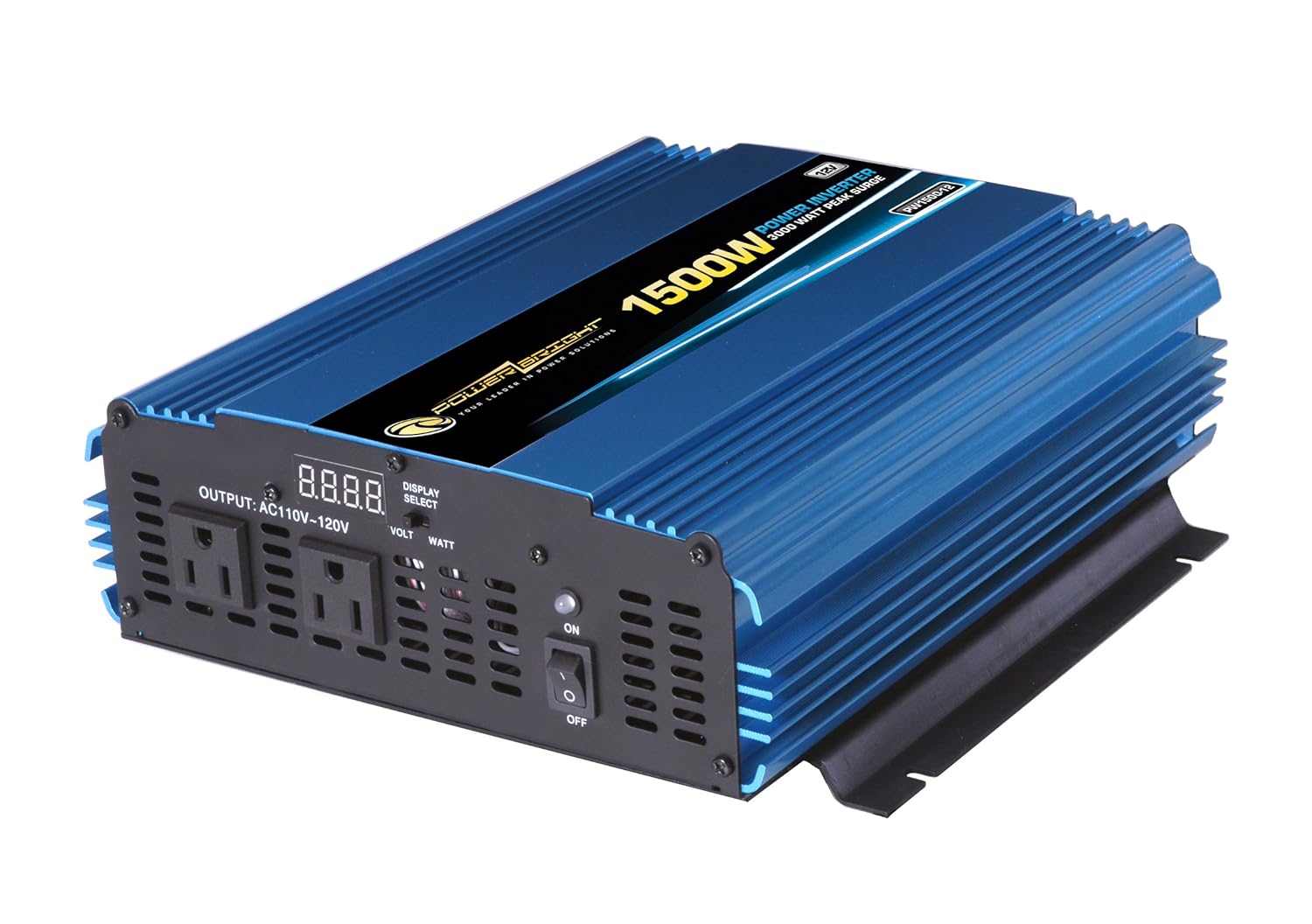

    That piqued my attention too. Right now, I have a 1000 watt emergency power outlet in the rear cargo area of my 2010 Prius. And I've never needed it for an emergency, just for camping. :)
    See it in my signature, "Add a 1kw inverter to your Prius."

    I've not tried it myself yet, but there are people who have powered their home during a power outage with their Prius. That was my argument (to my wife) for letting me do the 1 kw inverter installation in our Prius. At least to keep the freezer and refrigerator running, as well as a few lights in the house. But so far, we've not had any long power outages. So I use it to cook rice in a rice cooker on picnics and camping trips, as well as run a small microwave oven. I love the surprised looks I get - makes the whole project worth it!
    If I'm out in the middle of nowhere, I could hang a sheet on a clothesline and set up a sound system, and show videos with a video projector. I've wanted to do that, just because it's possible, but so far, have not. But think of the fun it would be!

    First, the inverter in the cars shown was a Japanese output one (100V 50 Hz). Don't expect that in North America. There won't be any notice of whether it will be offered in NA specs. until the cars are listed with the option packages.
    Second, I noticed in a few of the preliminary "mumblings" that the power outage emergency supply for your house would also be offered - in Japan. Again, until the cars are listed with the option packages we won't know if that might be available here in NA. This system doesn't use the 12V system, but rather the "high voltage" system (200VDC/560V three phase AC). It's a little easier to get the needed multi kilowatts that way. The 12V system is limited to around 12V 40Amp or 500W continuous (the internal inverter charger output on the 12V system). Much more for short periods using the battery, but at 40A-Hr capacity emphasis on the "short".

    Both our 2003 and 2010 Prius handle 1 kW continuous, 75A @13.8V. The 12V battery provides additional surge measured in 10s of seconds so a 1.5 kW inverter can be used with proper wiring.
    At 1 kW, our 2003 Prius is in the same efficiency range as the standalone generators. The Prius inverter runs while driving the car for laptop power or anything else that needs 120 VAC.
