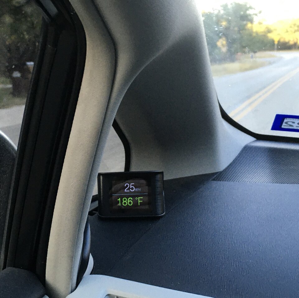

    I use a $35 P10 ECT monitor with custom alarming.
    I set it for 210f-220f depending on the season. It has gone off once after I forgot to fully tighten the reservoir pressure cap. It provides audible warning (you may not see the visible warnings) before the vehicle's 248f coolant light would flash.
    However the cooling system is solid and the early warning preventing anything is theoretical so far. Change coolant every 30k-50k with a simple drain and fill anybody could do.

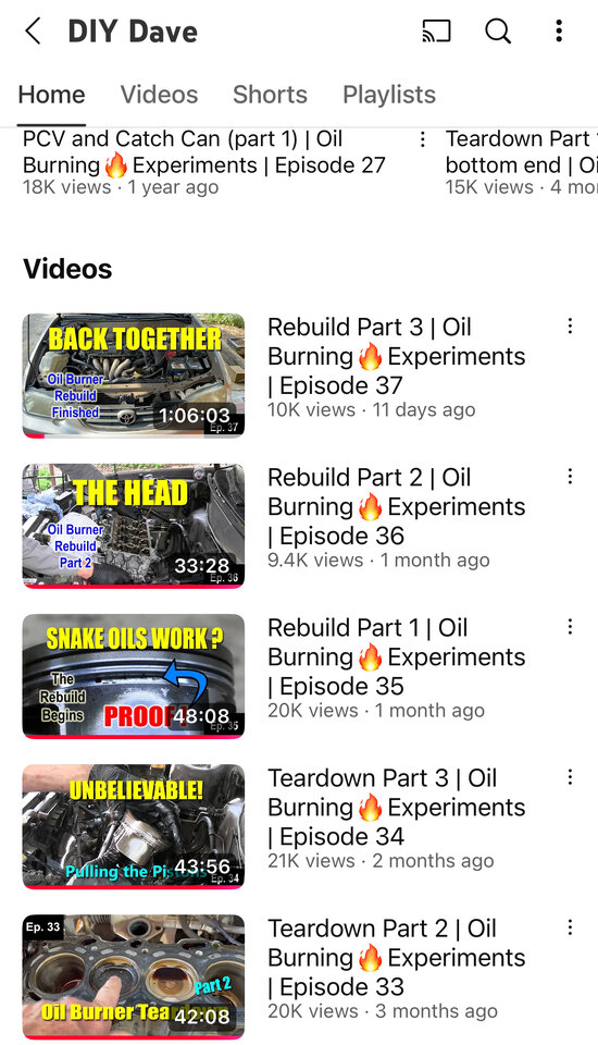

    There is a youtuber called DIY Dave that tried to fix his low tension Corolla oil burner with every additive known to man over 37 episodes. Some cleaned piston oil ports and rings very well as he demonstrated after giving up and tearing down the engine. We are waiting for the rebuild startup video as of this date

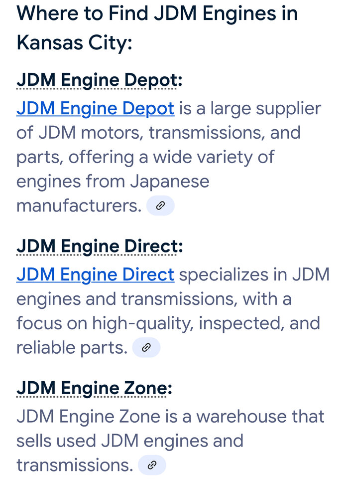

    JDM engines don't come with an identified year but simply fit in the range of Prius and Prius v years above.
    If an engine claims to be a certain year it probably came from a US salvage yard and is not a JDM used in Japan engine.
    Many salvage yard and online sellers don't know much as well and often misrepresent the source, mileage and condition of their engines.
    I would not buy a JDM engine on ebay or online. I would not buy one until you had an installer lined up.
    The smart move for a guy in Kansas City is to personally visit every distributor and ask questions including recommended shops to install a JDM engine. I would have the installer inspect the engine before purchase.
