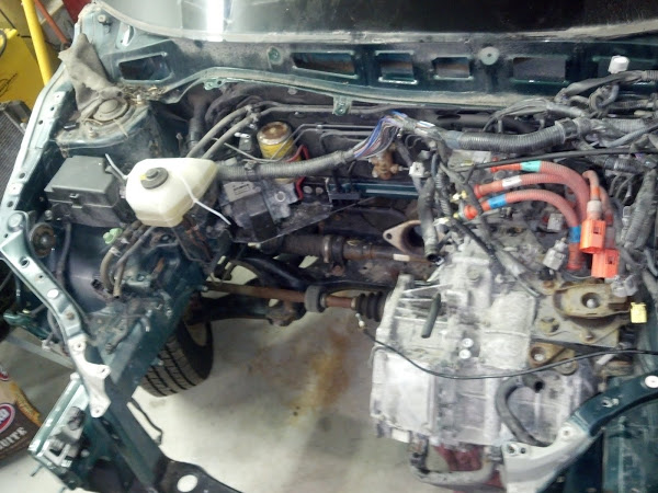

    Well I did get the miniVCI up and running; it was quite simple actually. I did not find it reporting the temperatures in the transmission though. I did confirm the P3120 codes though. With the time I've spent I still have the same code coming up and there doesn't appear to be a solution other than that dreaded transmission swap out. Unfortunately I'm lacking the funds to pick a known good transmission. I'm apprehensive to risk my money and time on a used trans that could have the exact same issue that I currently have.
    I've decided that I'm calling quits on this little '01 and parting her out. With the main battery selling Saturday I've recouped 2/3 of my investment already. The inverter has been removed and has now been listed. This is definitely not the way I wanted this to go down but I have to move on.

    Well another turn in the story... I was contacted about the engine. The gentleman thought it might be too much of a job for him to complete the swap himself. I'm considering buying his '01 NHW11 now. I'll try to get the engine removed from mine before making a final decision. His car appears to be very well taken care of until the connecting rod exited through the block wall. More pondering... :confused:

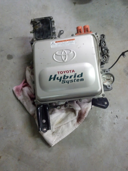

    2.jpg Continuing the dismantling of the poor NHW11... I'm about to list the new inverter pump I bought on eBay but then thought that I'd offer it up to the PriusChat folks first. I'll sell it to you guys for $100 delivered. If interested please private message me. More photos to come soon.
