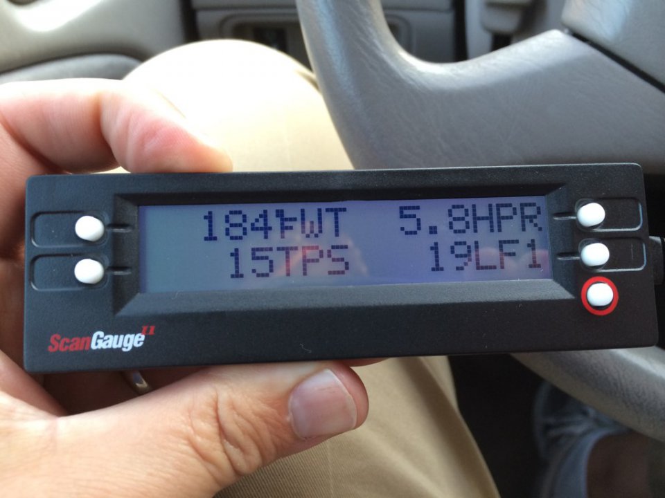

    Check engine light had been off. Drove 2 miles and engine light flashed then went back to solid on. These are the current values. I now have only code p0301.

    Eh, very close to nominal, nowhere near the ±20 limits ... no smoking gun there. Hmm.
    When you've cleared codes recently, have you just used the clear function on the scangauge, or interrupted the 12V power? I wonder if there might have been a different trim value that could have gotten reset recently in all the activity.
    Anyway, I guess that reading hasn't narrowed the solution set very much - sorry about nagging you for it. We still kind of have ignition or fuel delivery as lead suspects (compression being another possibility we haven't tested). The spark plugs don't look as bad to me as they do to Patrick (I think maybe it boils down to: I agree they show signs that bad combustion has been happening, but they don't look to me like the cause of it - they look like they would make sparks). Eric has seen bad ignitors cause these symptoms, and astrolink saw bad injectors cause them, so both of those possibilities are still in the lineup.

    The values did get up to 27-29 during that 2 mile drive. Not sure if that matters.

    Well, for comparison, I just now went and cold-started my 2001 and took it for a nice four-mile jaunt around town. The LF1 did vary slightly during the drive, but never once went outside of -5 to +5.
    If you saw 27 to 29, I think you saw a witness breaking down on the stand, pointing out in the courtroom at your fuel system and screaming hysterically. (Comments from others? Would numbers that high be equally consistent with a spark problem? Does unburned fuel in exhaust drive up the fuel trim too?)

    Last night, you finally did get one instrument reading outside the normal range by four to six times - something like getting a 300 MPH speeding ticket in a 55 zone. (I didn't notice until just now that you had a picture showing 19 LF1 - I must have been already typing my surprised response at seeing only 3 in your first picture). So we know that at times your ECM is calling for far longer injection pulses than it thinks it should have to, for the amount of fuel it wants.
    The ECM could be wrong, or it could be right. Wrong could be if the MAF is telling it way less air is going in than what's really going in, or the oxygen sensor is saying there's way more oxygen remaining in the exhaust than there really is. Or the ECM is right, it's getting accurate MAF and oxygen readings, and there is really less fuel coming out of a normal injection pulse than there should be.

    -the LF1 value is about 13 when I start the car and it hovers up to 33-39.

    Thanks. What stumps me is the LF readings of 14-33.
