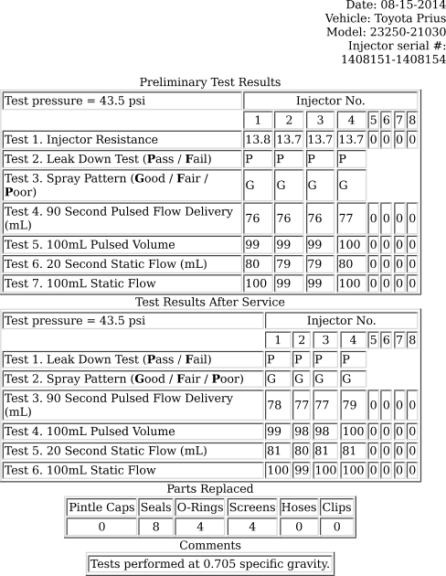

    Well, the injector results are in, and they definitely were not the problem. Those might have been brand new, as good as they tested ... scarcely any room for improvement:
    I'm sorry that was extra work for CClay for a negative result, but I thank him for being a sport in the cause of building PriusChat knowledge. So far we've seen: my injectors at 204,000 miles: pretty darned good; astrolink's injectors at 165,000 miles: definitely bad, and replacing them solved the problem; CClay's at (what is that, 176,000 miles? tried to read from your video): really, really good.
    Annnd, once again I'm in the position of having a great set of restored (hardly needed it!) injectors, for the next person who (might) need them.
    -Chap
