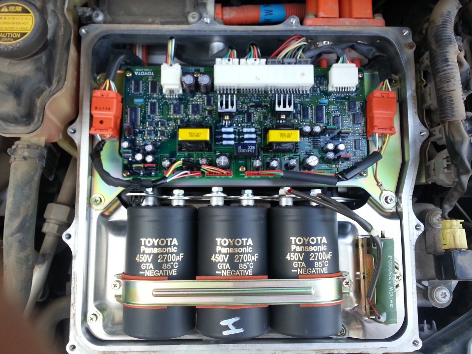

    I'm going to pull my inverter apart tonight and see if I can diagnose it a little better.
    I've come to learn there are at least two versions of inverter assembly for this vehicle; G9200-47070 and G9200-47071.
    Mine is 47071, but I can only seem to find the 47070 model at reasonable prices. There are several salvage yards with the older model available for <$200, but the newer ones I've found are $800+.
    I can't afford to spend hundreds of dollars and I'm not looking for perfect performance. How bad would it be to use the older inverter in place of mine?
    -Michael

    Going to wait for the "new" inverter to come in next week before trying to pull the old one out. I've made some interesting observations, though...
    Shortly after I bought the car, I thought I was going crazy. It felt like the car was "moving" while in park, very very slightly rocking back and forth, and it would stop when I applied the brakes. I was able to actually catch it one day and see the wheels moving ever so slightly. I assumed it was just a quirk of the way the Prius is designed.
    I'm wondering if that was an indication that inverter failure was imminent, because it's extremely obvious now. Sitting in place the car visibly and violently rocks forward and back. I can make it stop by giving the inverter a few hard knocks, but after a few seconds it acts up again. It's definitely not vibration from the engine.
    My big concern though, since it's showing a problem with a current sensor... did the current sensor fail, or did something else fail and cause the readings at the current sensor to go far enough out of whack to confuse the rest of the computer. I don't know enough about how the inverter works to understand why the current sensor is vital to the operation of the motors, or why both sensors would suddenly fail.
    The computer seems to indicate both the "main" and "secondary" sensors have invalid readings, but doesn't tell me what exactly that means. Are they two sensors, one each monitoring the two motor coils, or is it two sensors giving redundancy to one reading? If they're separate sensors, did they both fail at the same time? I found one of the current sensor assemblies, but can't get access to it. The other one is buried deep inside the inverter.
