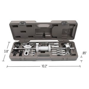

    Can you show me what kind of slide hammer I am looking for? Is this a tool I can get on loan from auto part shops?
  7. ChapmanF
    28,747
    19,050
    A set looks kind of like this:
    Notice one or two attachments in there that look sort of like duck feet, with three slotted toes and a slot at the heel. You should be able to get one or the other of those to fit over a couple of your hub studs, put your lug nuts back on those, and then bang away with the slide hammer pulling away from the car. Yes, most auto parts stores probably have one you can borrow.
    I had to slide hammer for several minutes straight, leaving my arm very very tired.
    My whole hub bearing unit came out, which was what I wanted to happen. The other possibility is just the hub pulls out of the bearing, which would have been a disappointment. (But then you can maybe insert the slide hammer shaft through where the hub went, then put some attachment on the end big enough to get behind the bearing, and resume hammering to get the rest of it out.)
    These days, I own an air hammer, and if I had to do it again I think I might air hammer around the base flange of the hub bearing unit, trying to get it to turn one way and then the other (with the bolts removed of course). That might loosen it enough to come out. Or, if I could get it turned enough for the bolt holes not to line up, I might be able to press it out the rest of the way by reinserting a couple of the bolts.
    And the air hammer would be doing the hammering, instead of my very tired arm.
