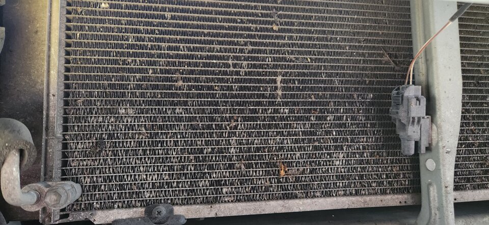

    My 2009 Prius with 350k miles:
    The AC works fine but struggles on hot days. This photo doesn't show the worst of it. Most channels that don't have bent fins are packed with course sand. I spent about an hour straightening and trying pull or push course sand out and realized that it would take a day of doing nothing but that. If the radiator wasn't behind i'd trying using compressed are to free up the channels. Might still be worth removing the radiator temporarily but I did a coolant change only 50K miles ago.
