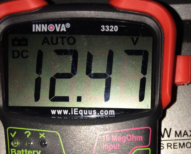

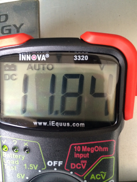

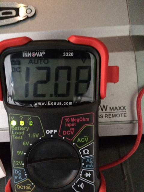

    Got the volt tester
    Everything off with back hatch open
    With lights on and back hatch open
    After min lights on back hatch open
    These done directly to the battery

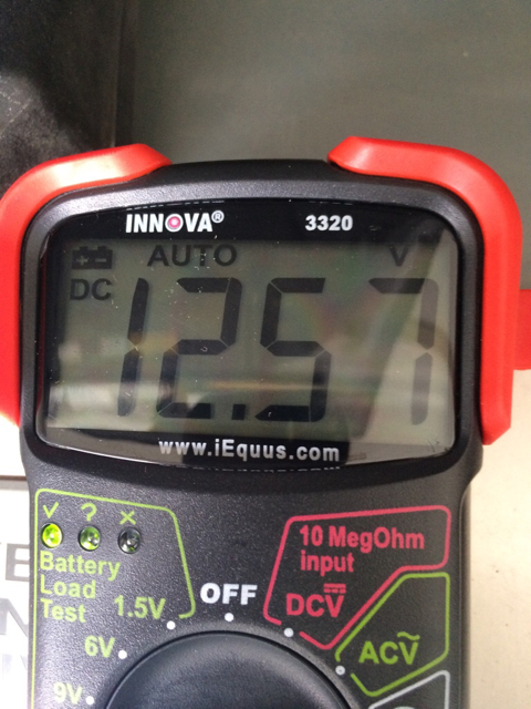

    Tests with Lights off at the front of the car

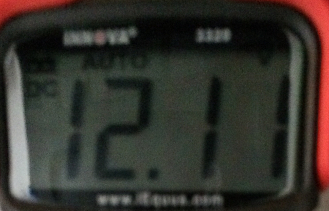

    With lights on
