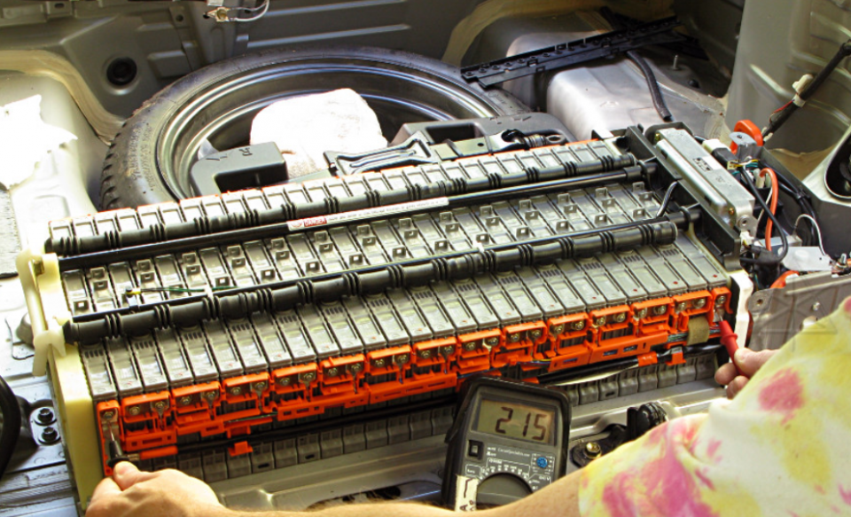

    There's no danger of installing the service plug with the battery case open. Here's a photo of a helpful hobbit checking the voltage on his battery. As you can see on the right side of the photo - the service plug is installed.
    You will get the same voltage at the two orange cables inside the BCU case.
    Of course you do need to have the service plug removed to connect the two orange cables inside the battery control unit compartment but you don't need to do that if you're merely checking the voltage.
    Just don't forget to remove the service plug again before you put the battery back in the car when you reinstall the other two orange cables that are behind the rear seat that connect battery power to the car.

    No danger.... um I don't think most people exposed to 215v DC wouldn't say there is *no* danger.
    In fact this is where it may be the most dangerous.
    Should a child, pet, or knowledgeable coworker touch the wrong areas by accident, it would be quite bad.
    You should be on high alert when checking a battery in this manner.
    #118 ericbecky, May 19, 2016
