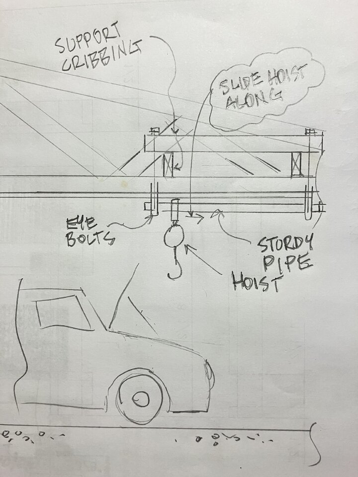

    I’ve thought about doing an engine lift in our garage. First off, a 200 lb engine, while not trivial, is not a lot. If a 200 lb person climbed up into the attic and starting walking around atop the ceiling joists, I doubt anything would break, let alone deflect.
    My thought would be to use a relatively cheap hoist, say a come-along suspended from a sturdy section of horizontal steel pipe, securely underslung from the garage ceiling joists (spreading the pipe support loads over at least two joists), in such away that you can “scoot” the come-along (with raised engine) a few feet along the pipe, enough to be beyond the car.

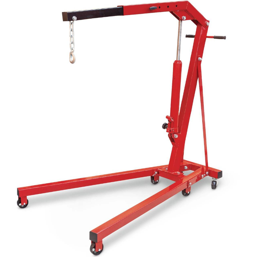

    Neighbour two houses over from us has one of these:
    And maybe one of these:
    It IS sand pounder to acquire such if you''re likely to use only once or twice. I wouldn't doubt you could find them cheap on Craiglist too

    I was able to get a cherry picker engine hoist on long term loan from a friend of a friend.
    Not too worried about the cost now on that.
    Should I get an engine leveler or are straps good enough?

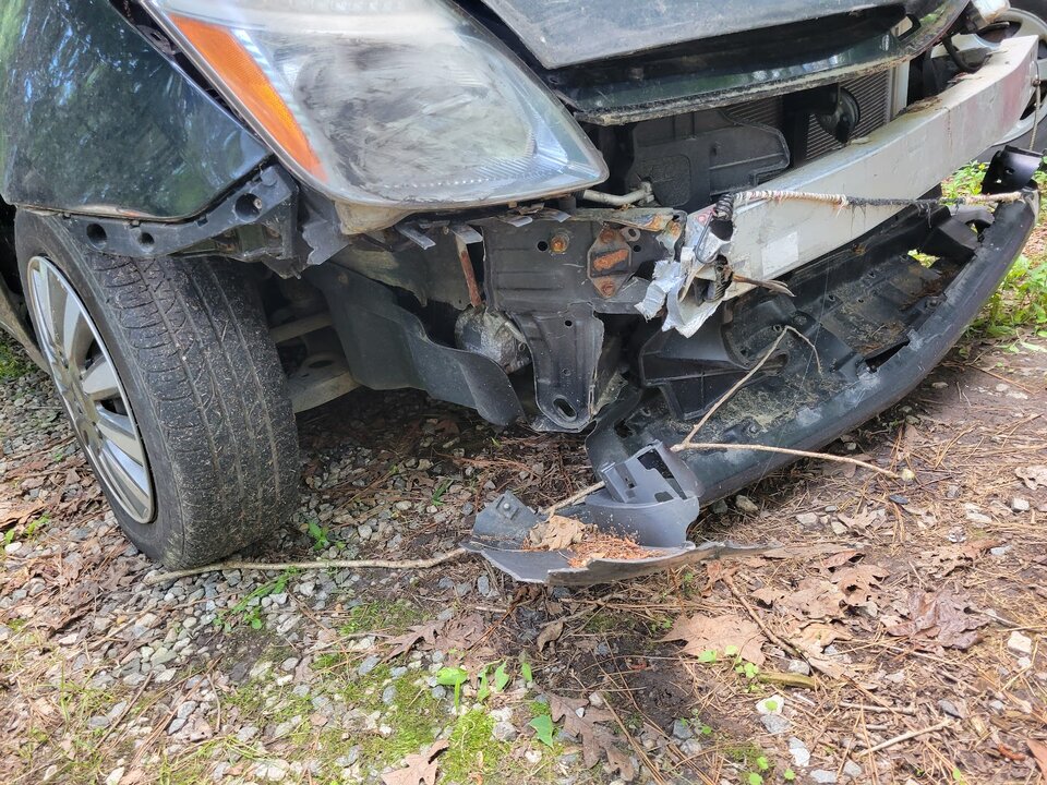

    My question is how much rust is under the car? The second picture
    Also your profile says you are a 56 year old female. Will you have any help?

    I am not sure how much rut is there. . . . .Is there a concern with that?

    Rust makes disassembly more difficult sometimes requiring torches or drilling. Some rusted parts will need replacing. Working under a car means jack stands on solid surfaces for safety.
    I would inspect things carefully before tearing into it. Having a second set of eyes look it over would be great.
