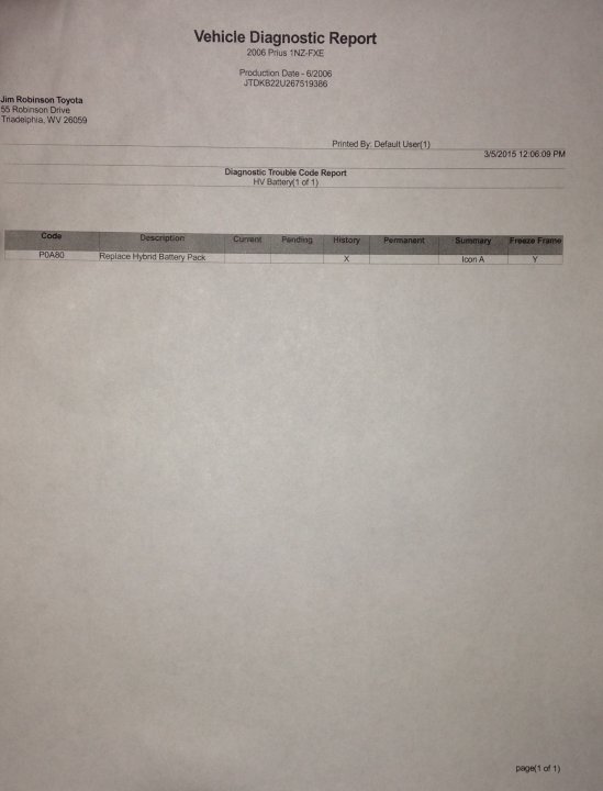

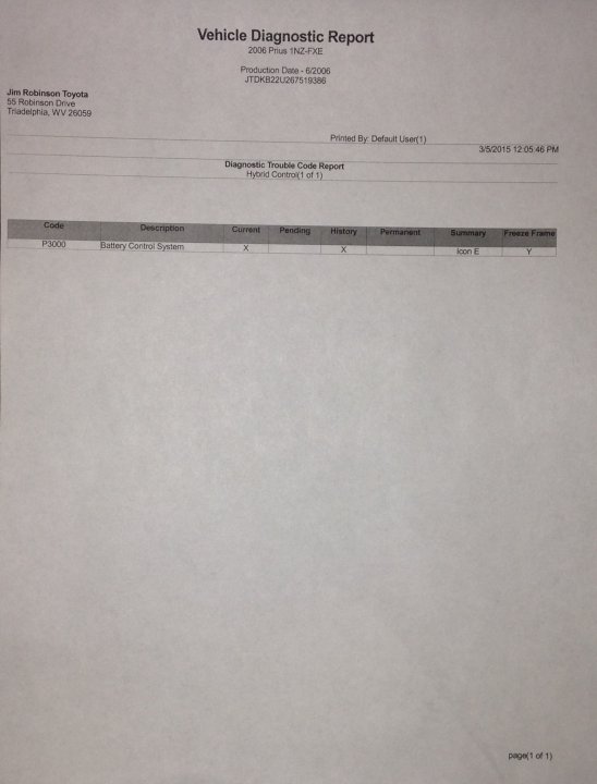

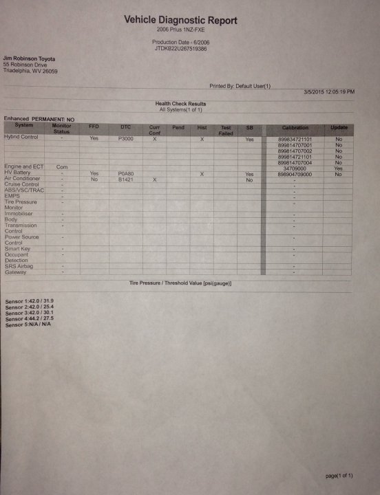

    Well, I went to the dealer today. They had the car for 2 hours and came back and said there wasn't a current issue, and that the code was stored in the cars computer as history, but not a current issue.
    They said the battery may be getting weak which explains the battery going from full to empty every 25 seconds and the battery fan on full blast. They don't recommend replacing it because it's not a confirmed failure.

    The HV battery is shot though. In the dealer diagnosis, it states (HV BATTERY BANK #4 BECOMES WEAK).
