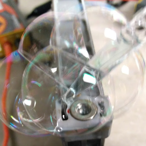

    Chap was referring to the possibility of replacing just the leaky battery module. Phoenix Hybrid Batteries has found leaky packs to be very difficult to rebuild. Once one module leaks the rest of them are much more likely to leak also. It's caused by the extreme Arizona heat.
    Here is where the Gen 2 modules leak. It's not the same as the leaky terminals of the Gen 1 modules. The plastic battery module case cracks next to the mounting bolt. This module was under a slight over charge to give it just enough internal pressure for the bubble soap to work.
