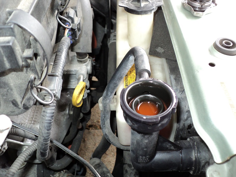

    If you still have other noise after that, then you may be looking at ICE damage due to the low oil. Remember, the lower dimple on the dipstick represent 1.6 quarts from full. Top dimple represents full. 3.9 quarts MAX when doing a oil and filter change. 4 quarts is TOO MUCH. Anything over the top dimple represents a overfilled ICE. Over filling the ICE with oil contributes to excess oil in the intake manifold and can cause problems with starting and overall operation of the ICE.
    Too late now if damage is done, but it might be a good idea to educate all the driver's to check the oil at EVERY fill up along with checking the fluid levels that are visible. NOTE: Concerning the radiator. Looking at the overflow bottle on the Gen II is not always sufficient. Sometimes the radiator can be low and the bottle still be full. For best results, remove the splash guard over the radiator and check the fluid level underneath the cap. It should be full to the top of the neck. See the picture below for a good example of what a full system will look like. Always check this when the ICE is COLD. Don't remove the cap if it is warm or hot. Risk of fluid loss and scalds or burns due to hot coolant.
