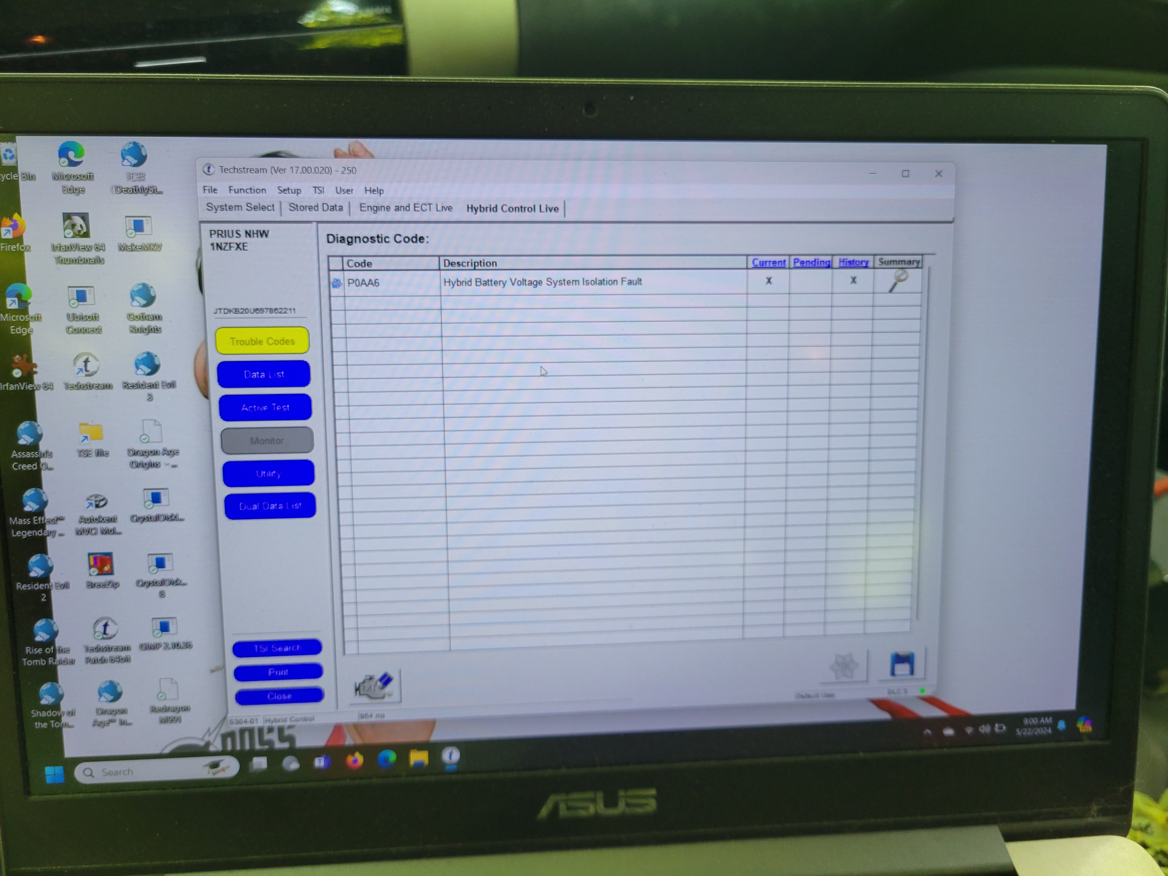

    "Hybrid Battery Voltage System Isolation Fault"
    When I get home from work tonight I plan to find the Techstream sensor. First thing in the morning I plan to test the car with Techstream. I think I know where it is but have not used it in a year. How hard is that problem to fix, assuming that? I have replaced the whole battery on a 2003 Prius. Will not buy anything until I am pretty sure I know where I am going.

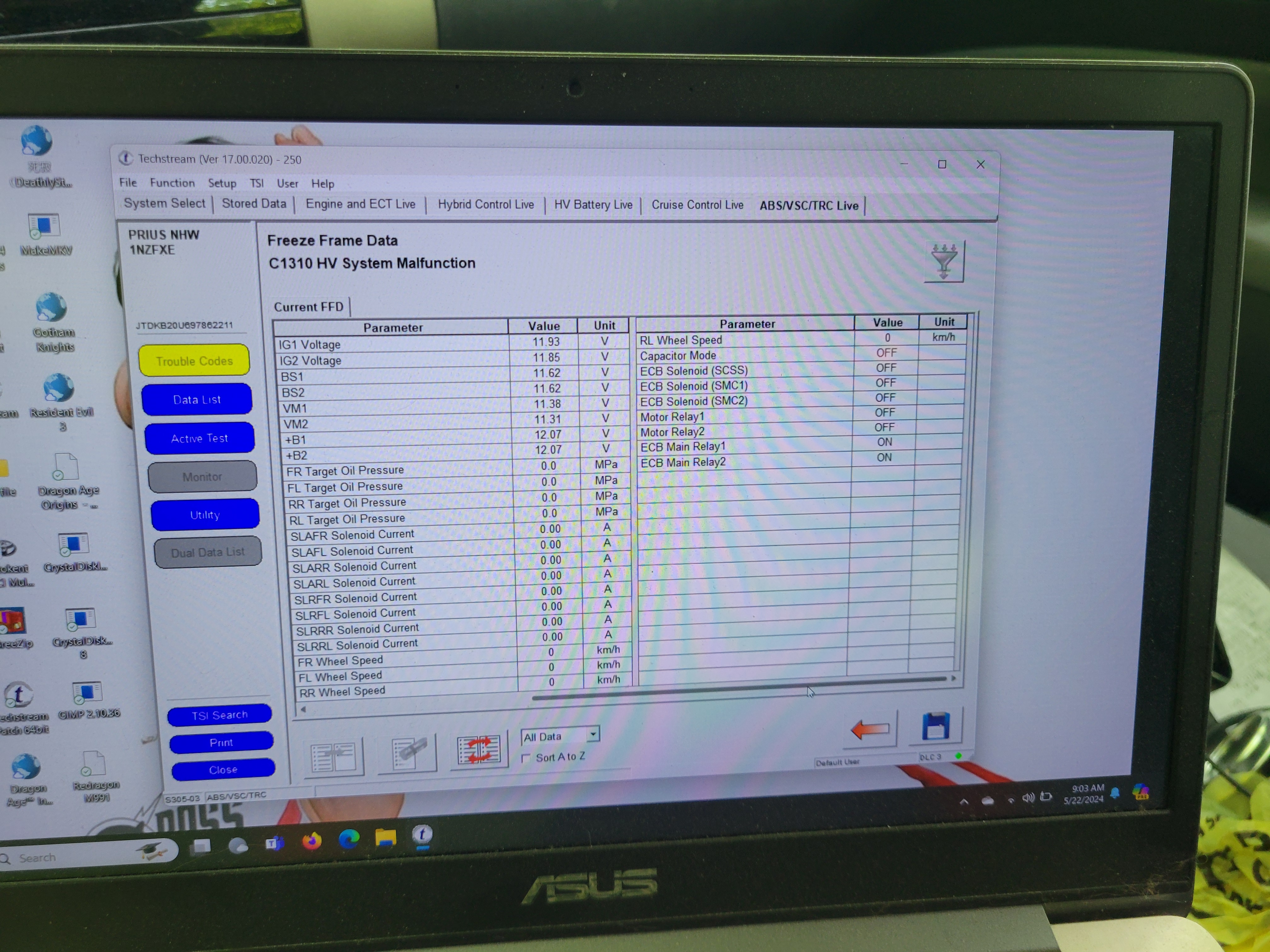

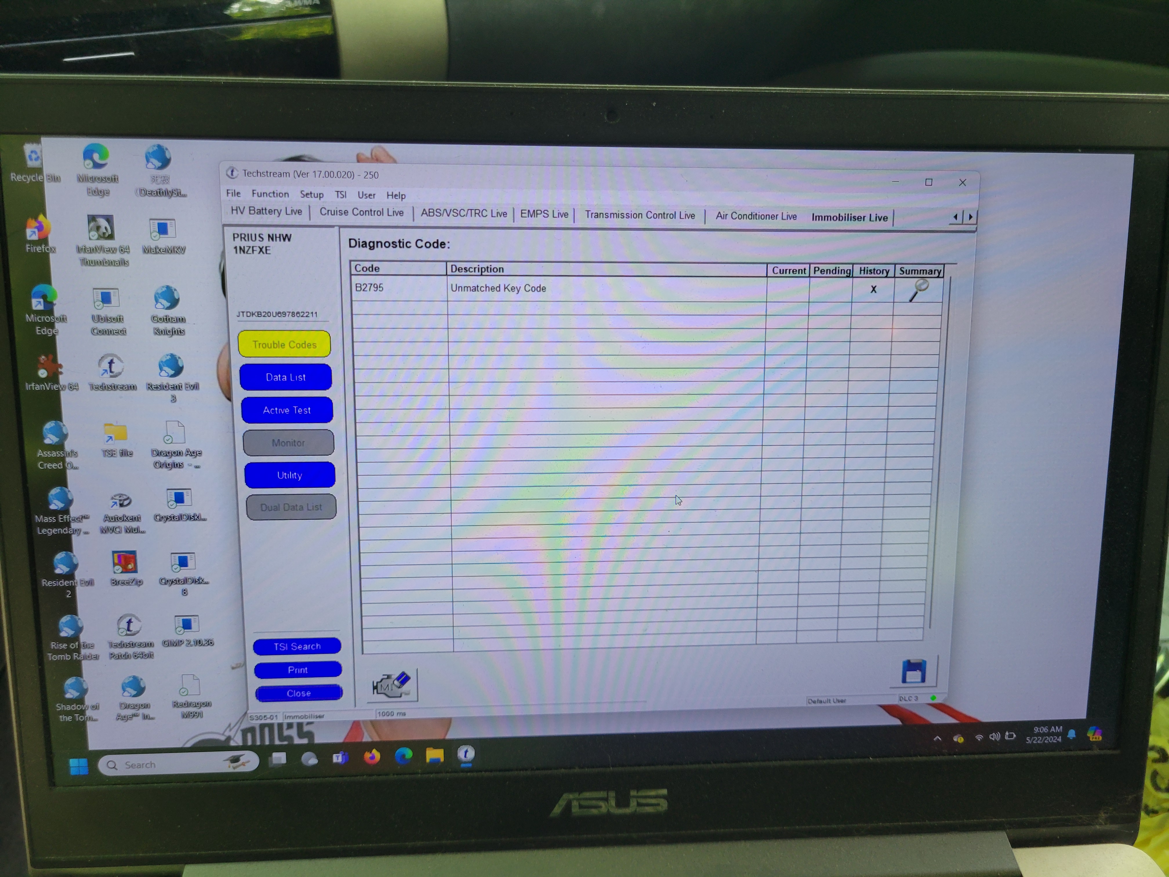

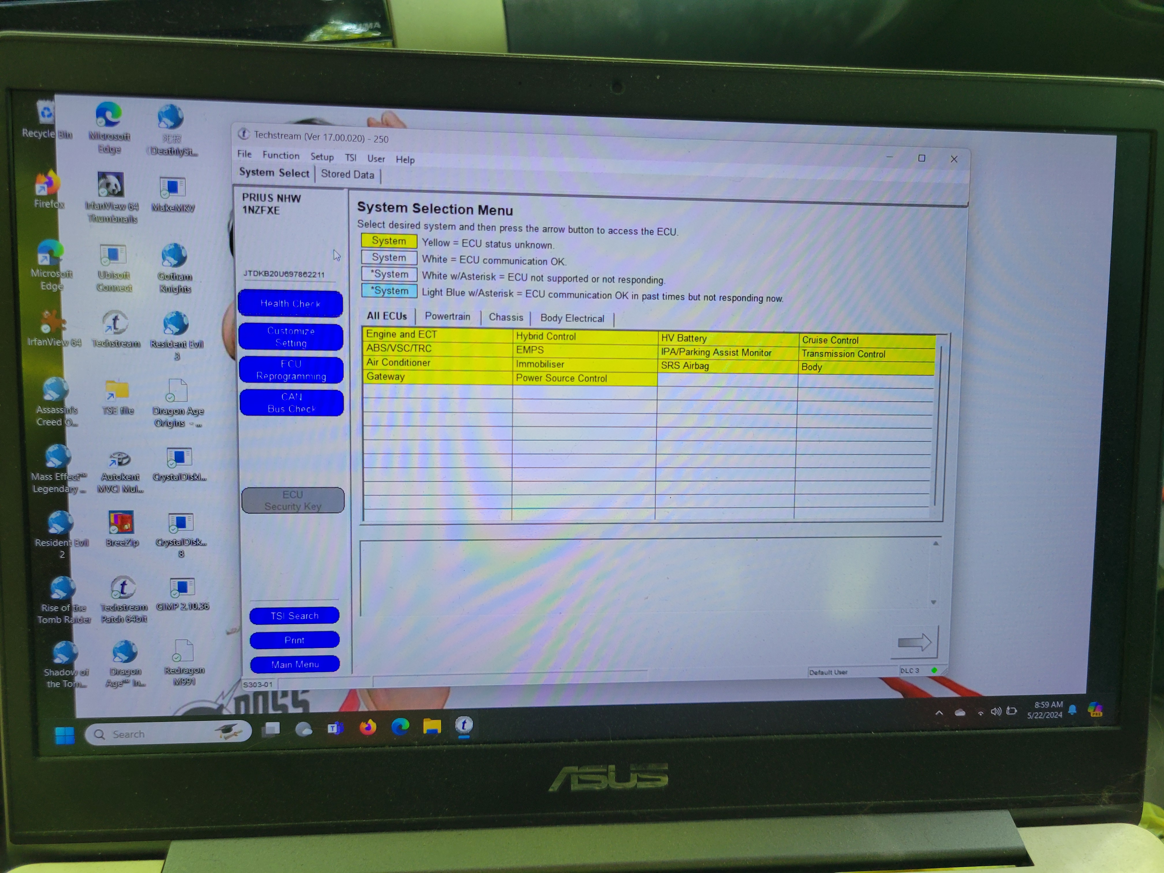

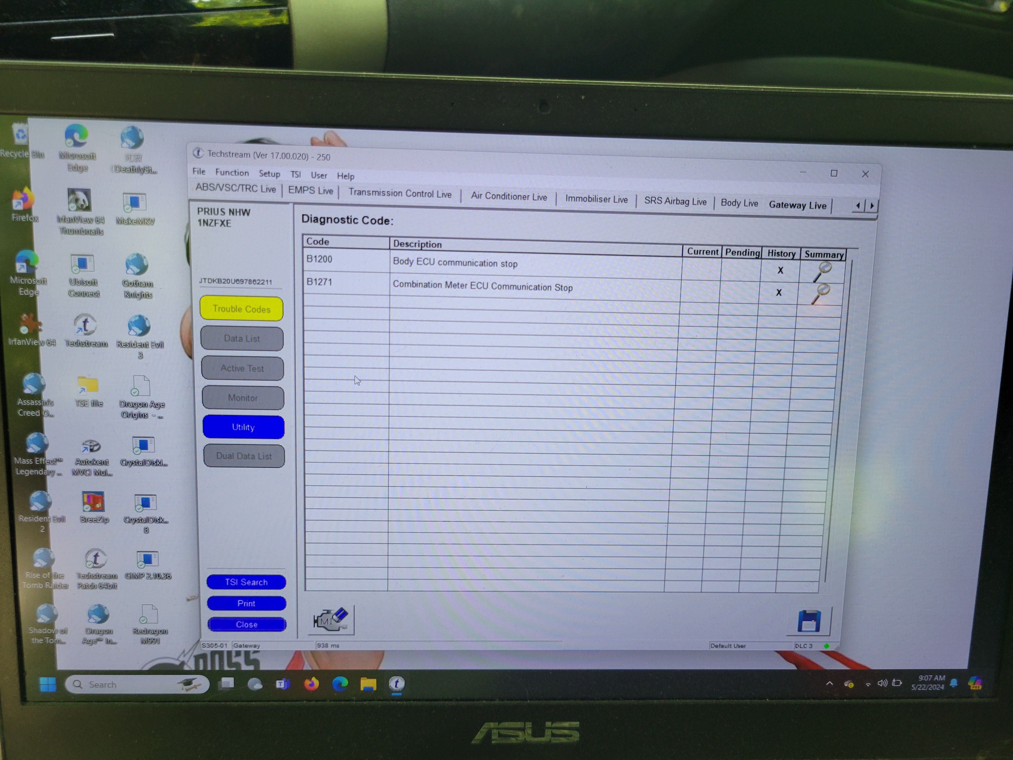

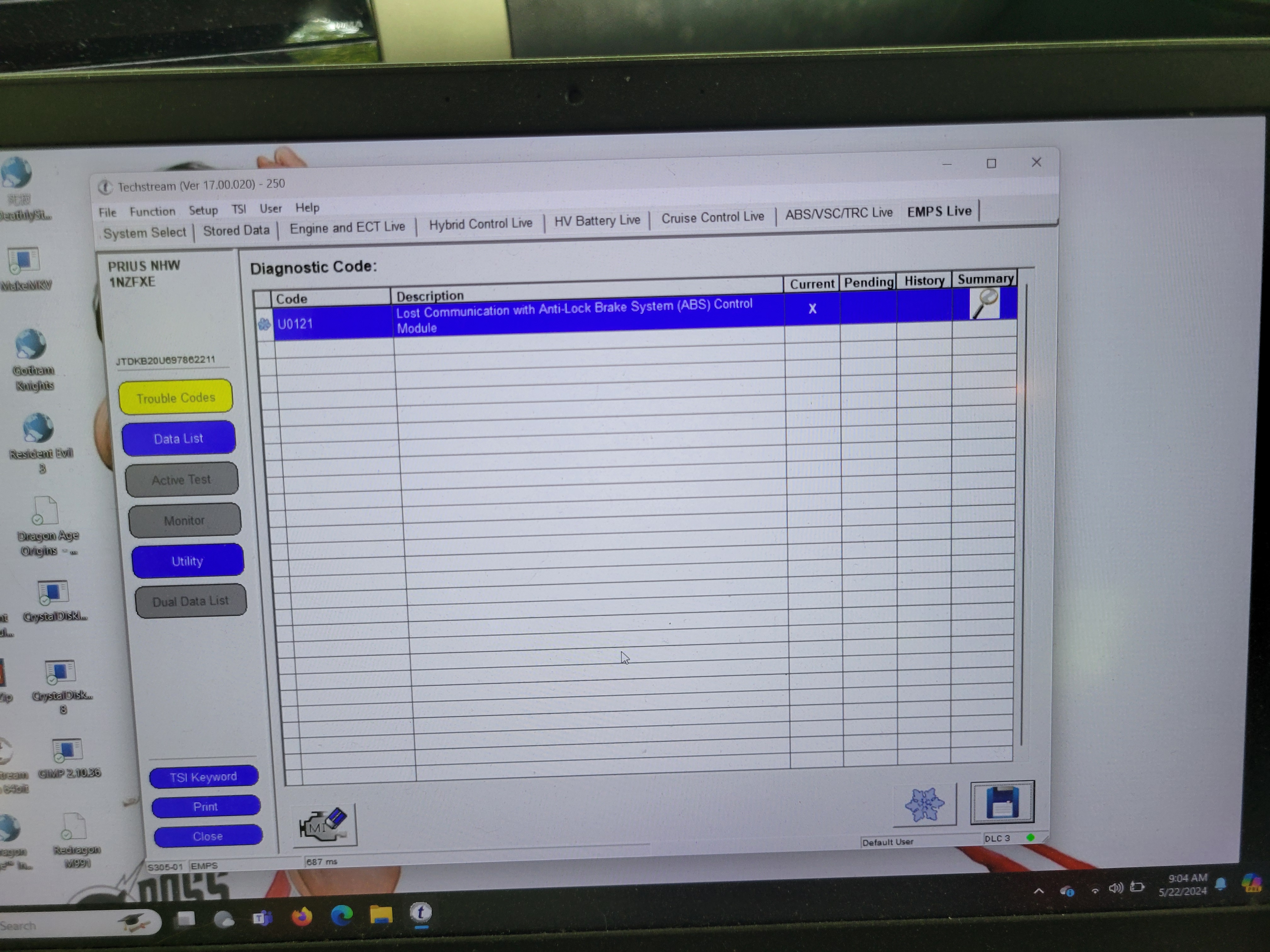

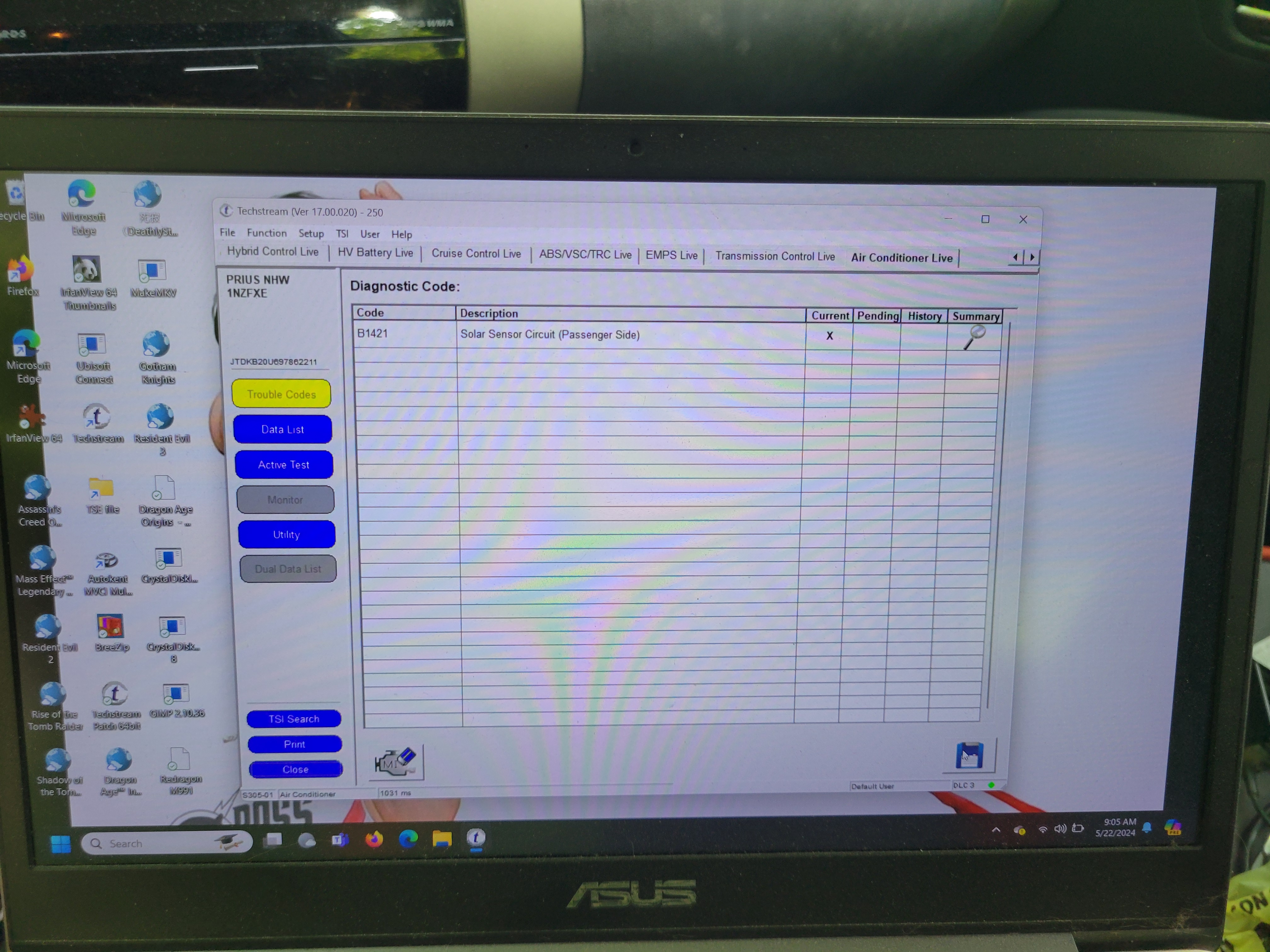

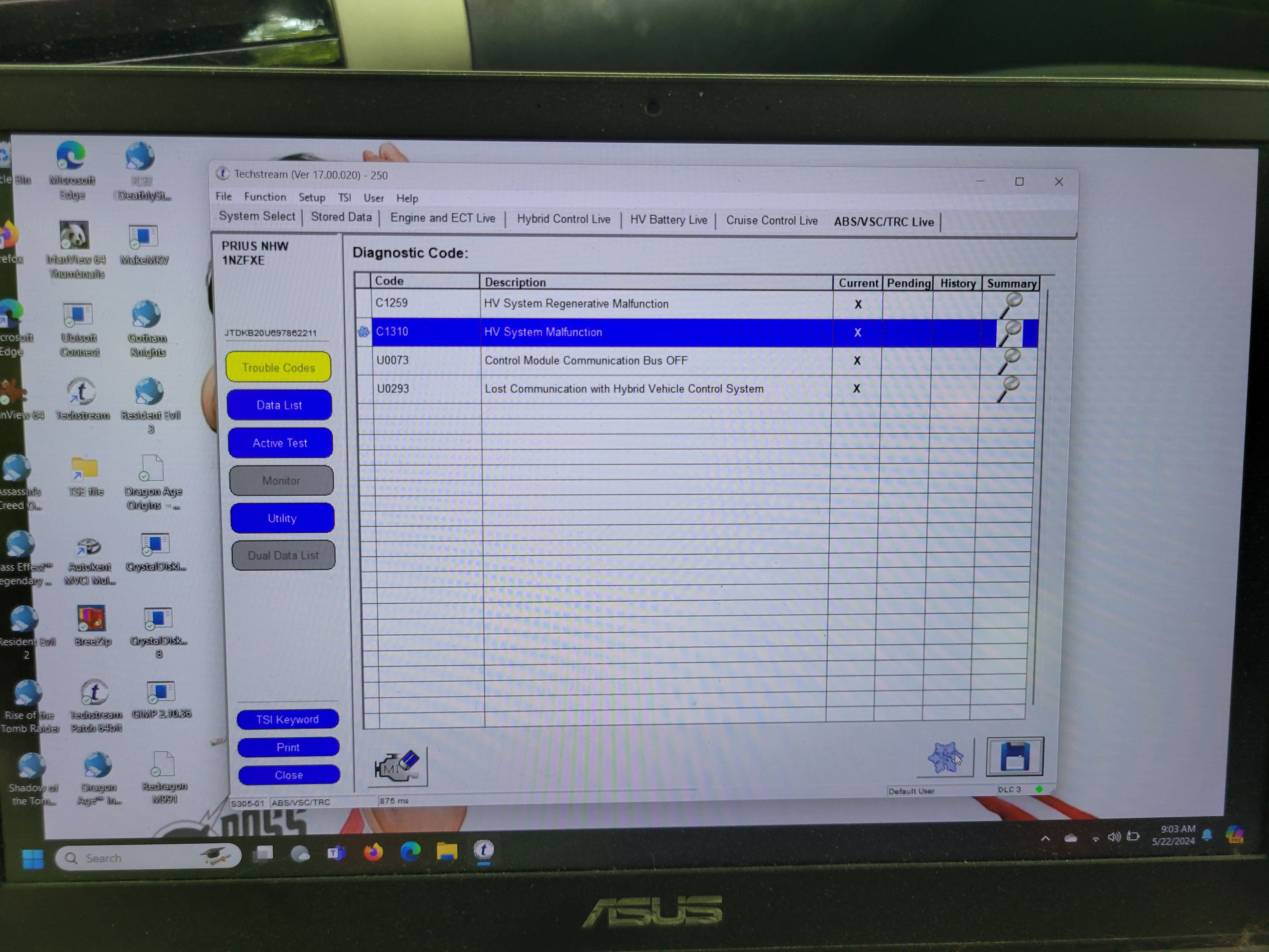

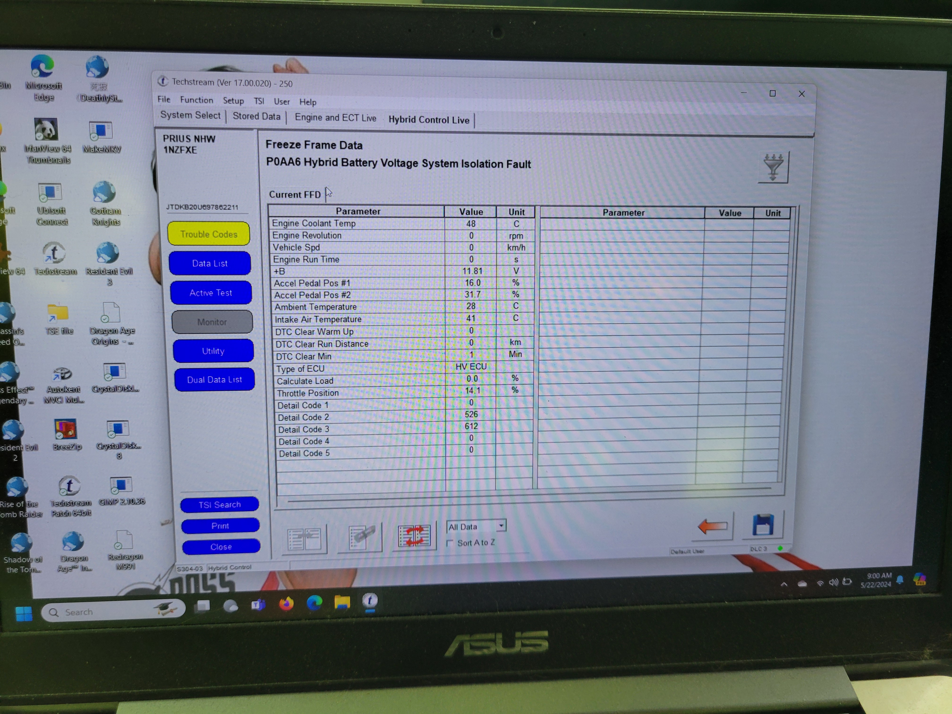

    Well, I think you called it. Posting some other stuff too but likely either not an issue or minor stuff
    I know nothing is ever 100% but does it look like I need to simply replace the module on the battery? 612 matches the ECU location and surrounding area. There is a module on the battery on the 2003 and assuming it is something similar? Also, assuming the module is the most likely cause, do I need to match any codes or can I just order any tested module from eBay?
    Ugg, is that ECU also the device that stores key information and other stuff? If so, do I need to get one reflashed?
    #5 KitsuneVoss, May 22, 2024
  6. ChapmanF
    28,689
    18,994
    Funny how that diagram is drawn so not-to-scale. It makes the ECU look huge. That little column of small long-line/short-line pairs to the left of it? That's the whole stack of battery modules (accounting for much more of the real size and weight of the battery than the ECU does!). The 612 area includes everything from the orange service plug and its socket, the battery modules and ECU and their wiring, up to the supply-side terminals of the SMRs. (The load-side SMR terminals are where the 614 area starts.)
    You still have the job of finding out where within that whole 612 area you have a current path between something and body ground (or something and the 12 volt wiring). But at least that's an easier job than if you didn't have the INF code, and had to look for the problem somewhere in the whole car.
    The C1259 and C1310 codes that are also showing are just codes the brake system will post when it knows there's a hybrid-system issue, so those are just there because of the P0AA6. No need to be concerned with those.
    The U codes I don't have a ready story for, but anyway, after the P0AA6-612 is fixed, there'll be time to look into those, if they're still present.
    No, there are about a dozen ECUs in a gen 2. The one inside the battery is just responsible for monitoring its current, voltages, and temperatures.

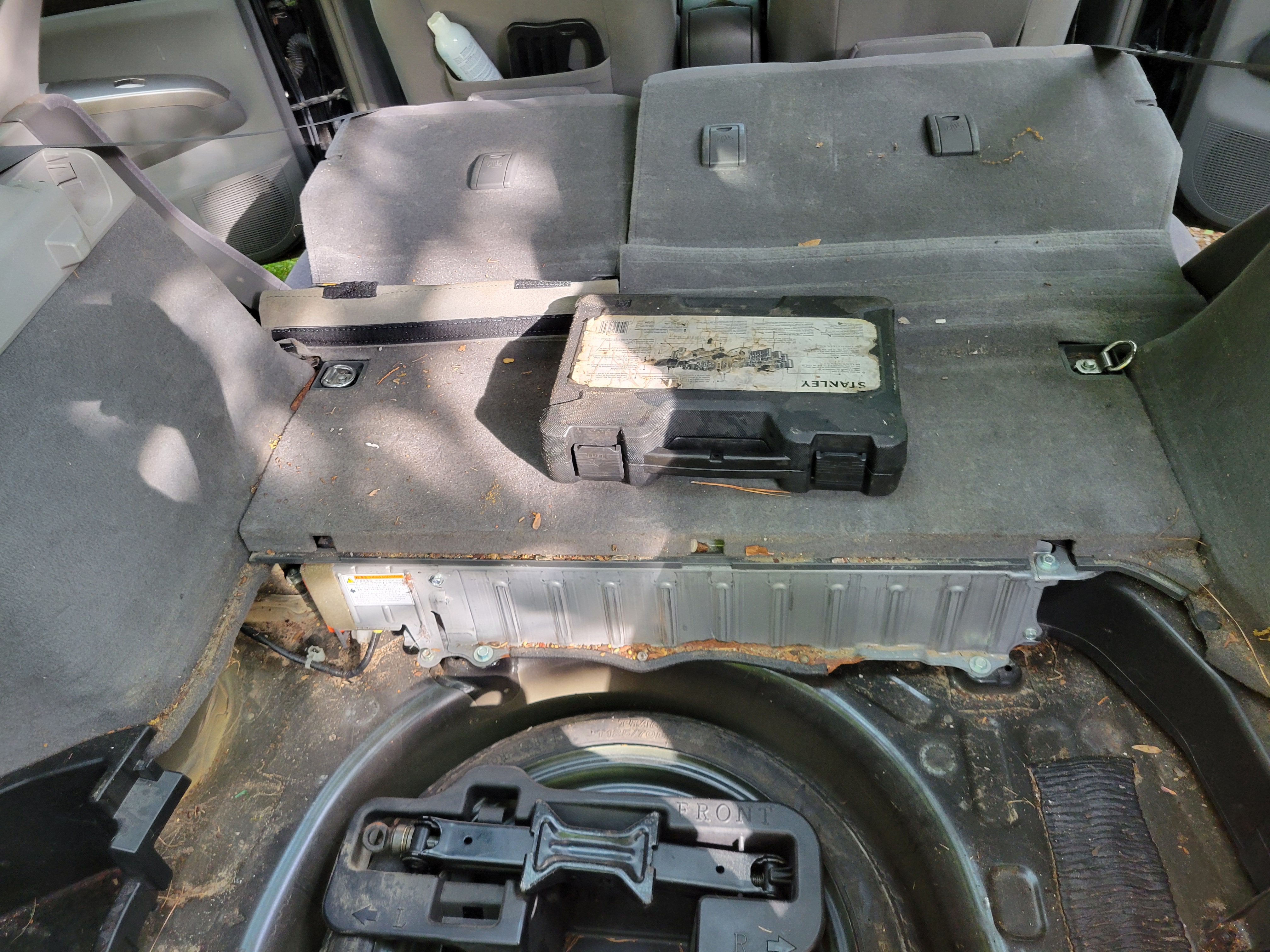

    Edit: I think my next step is to get at the battery and other stuff tied to it and have a look?

    Yes, disassemble the outer case and inspect the base where the modules bolt down. If there's a leak, you'll often see some corrosion or discoloration on the sheetmetal.

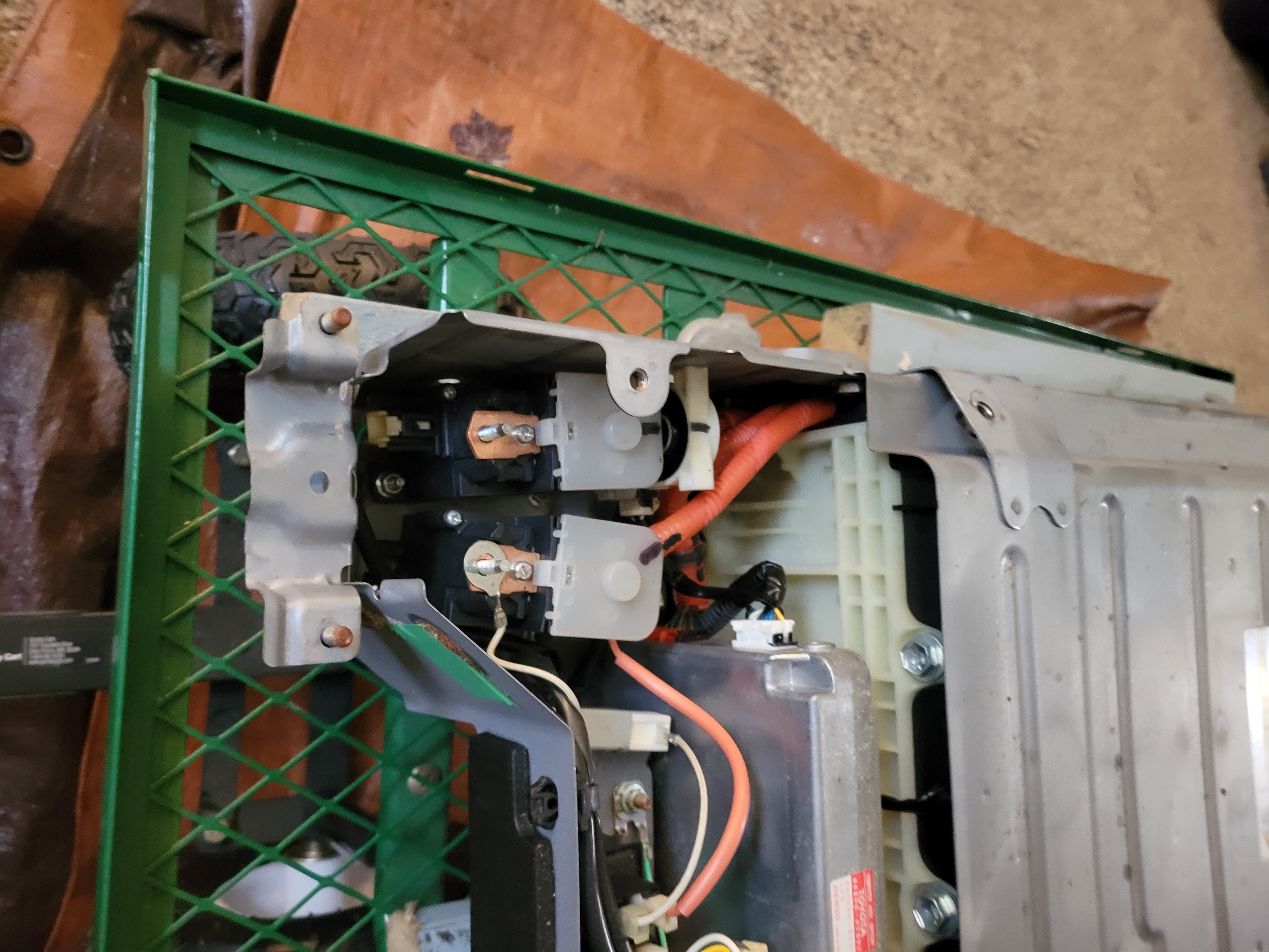

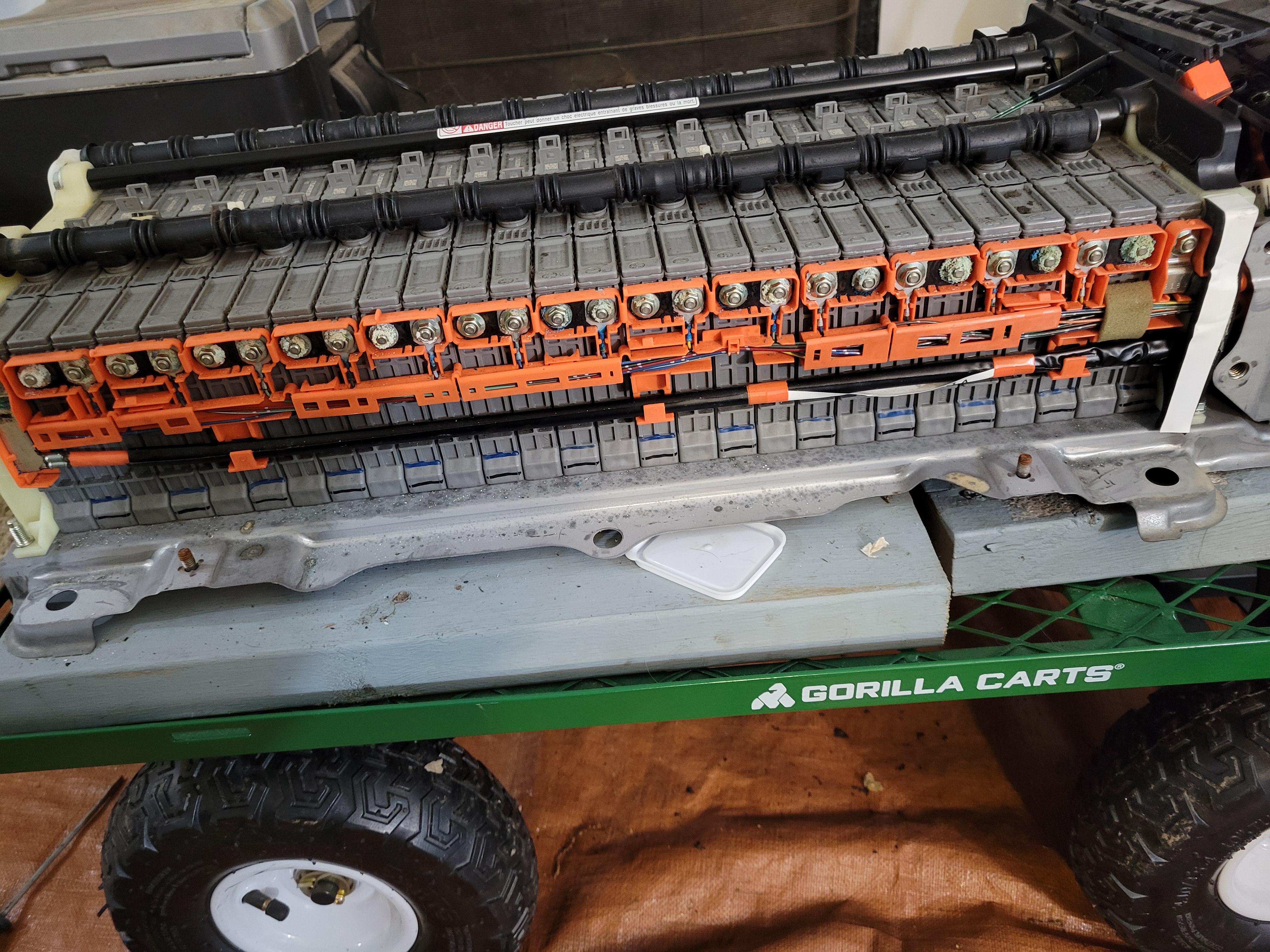

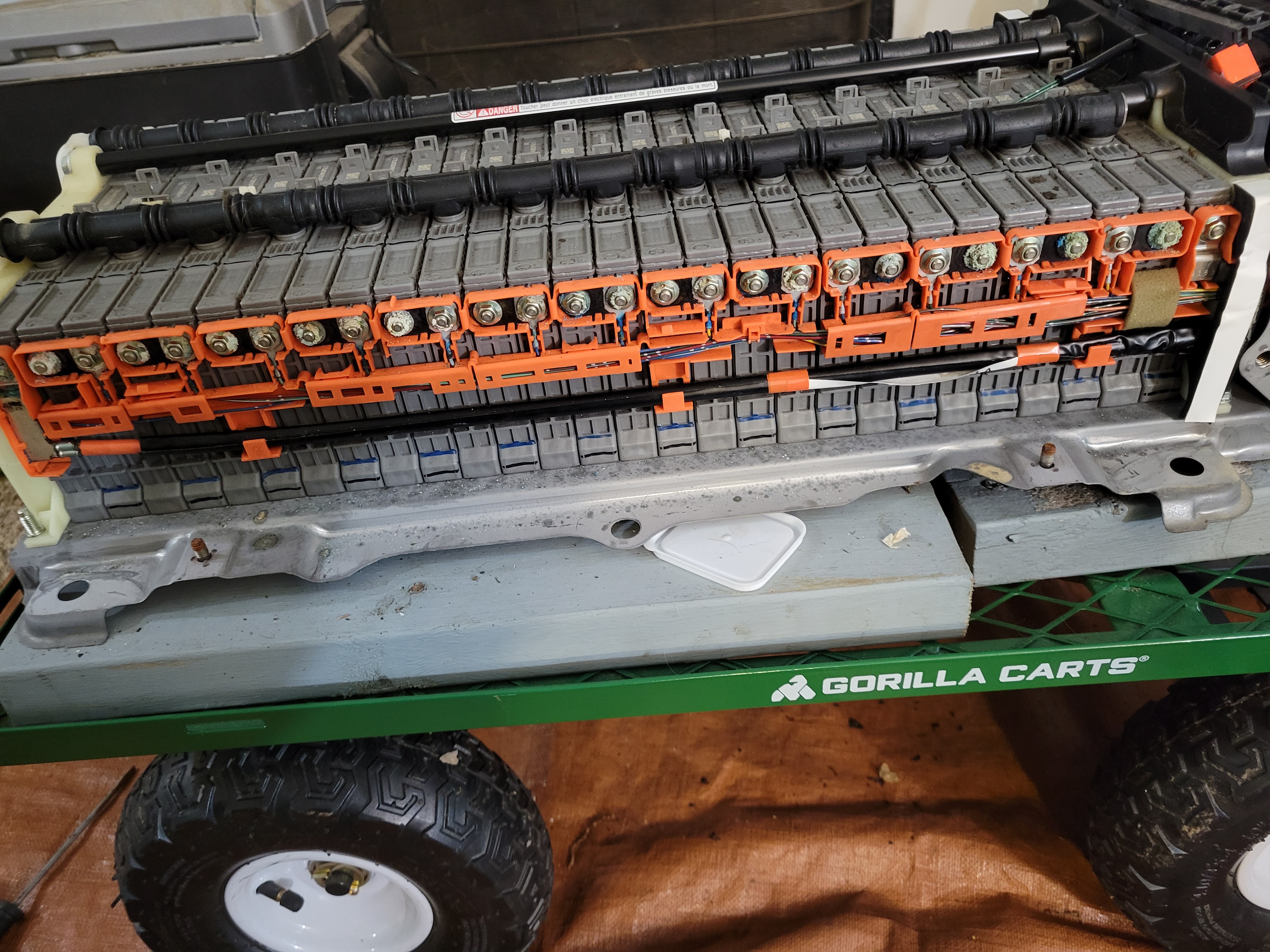

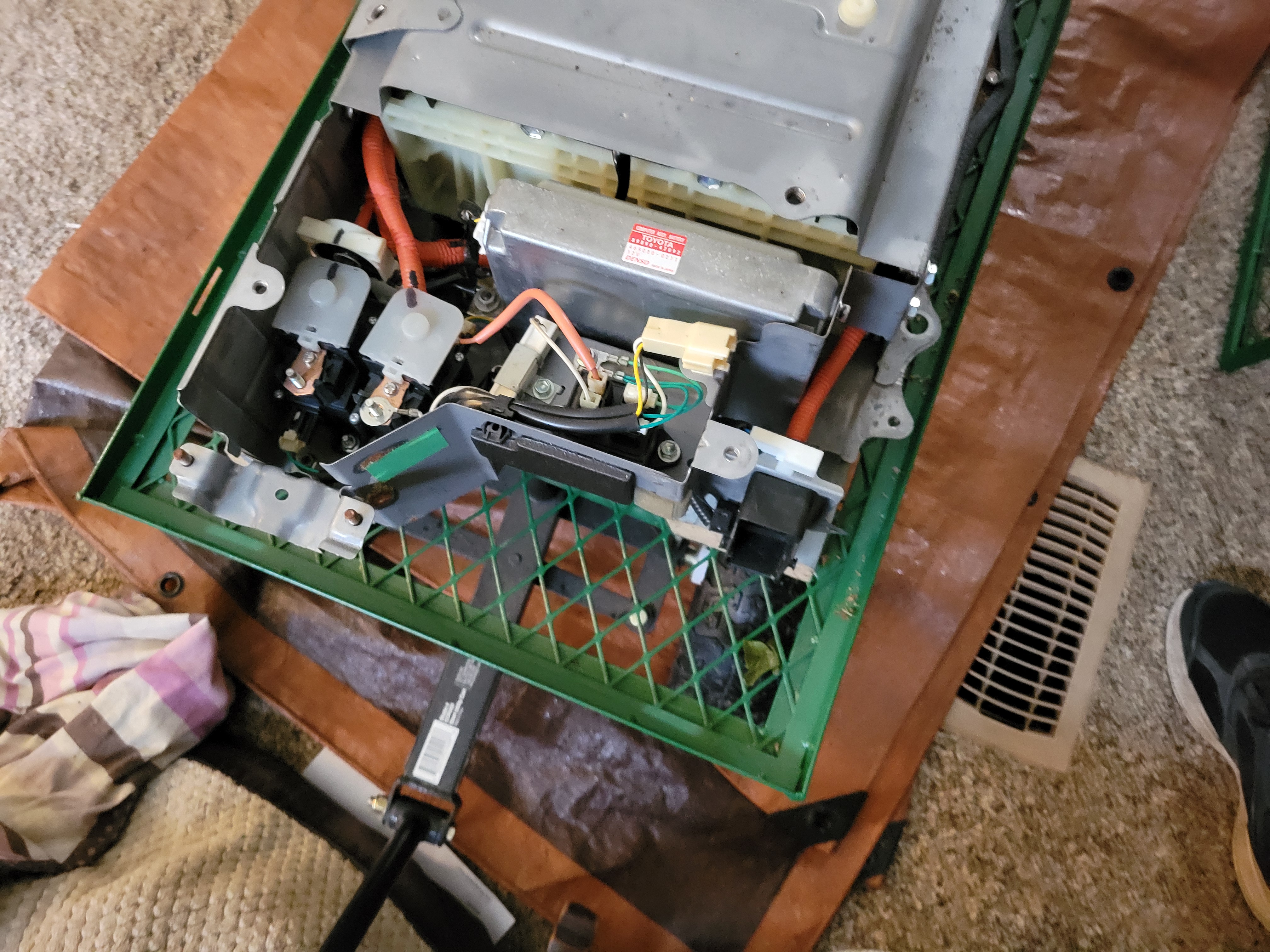

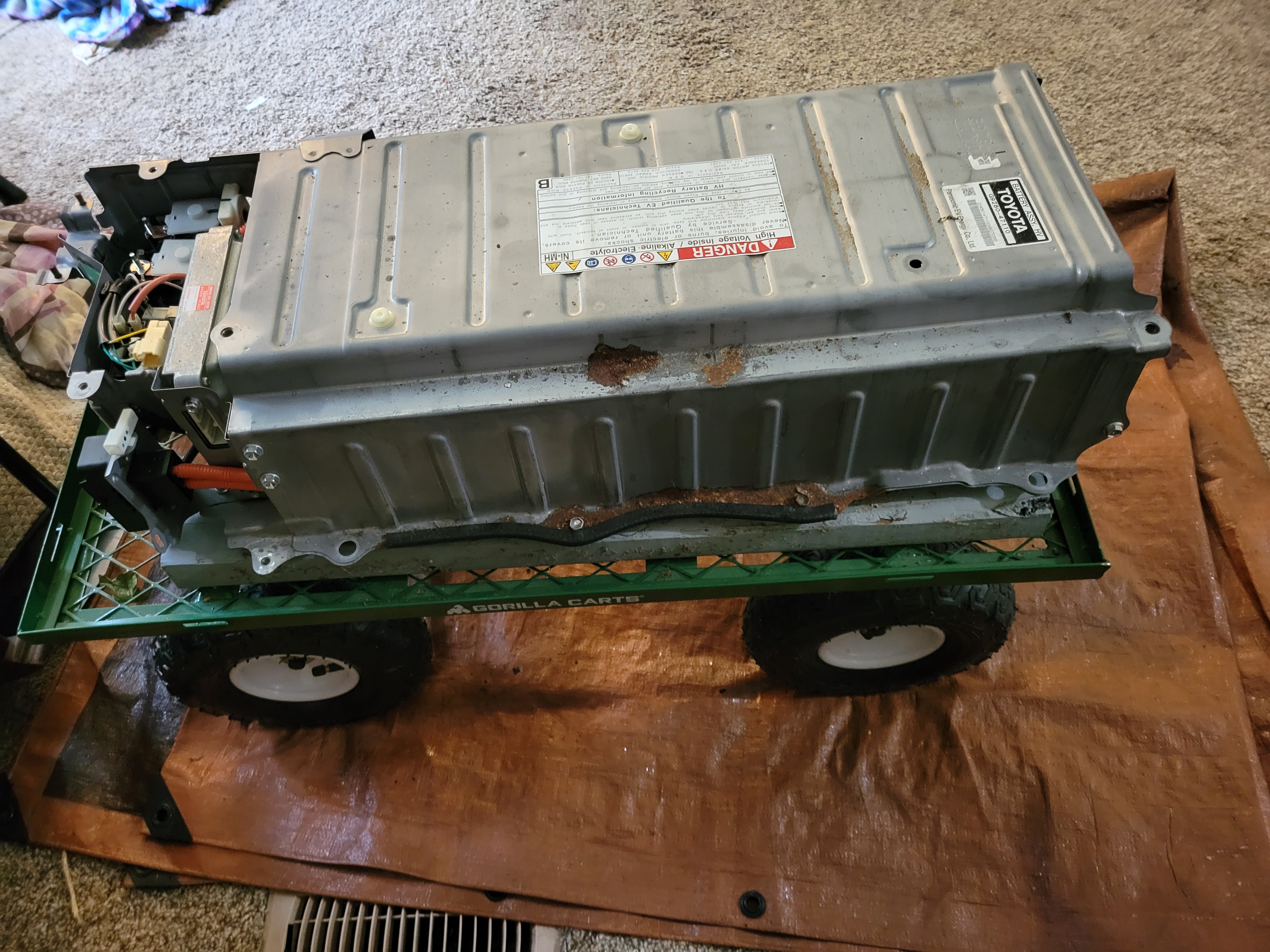

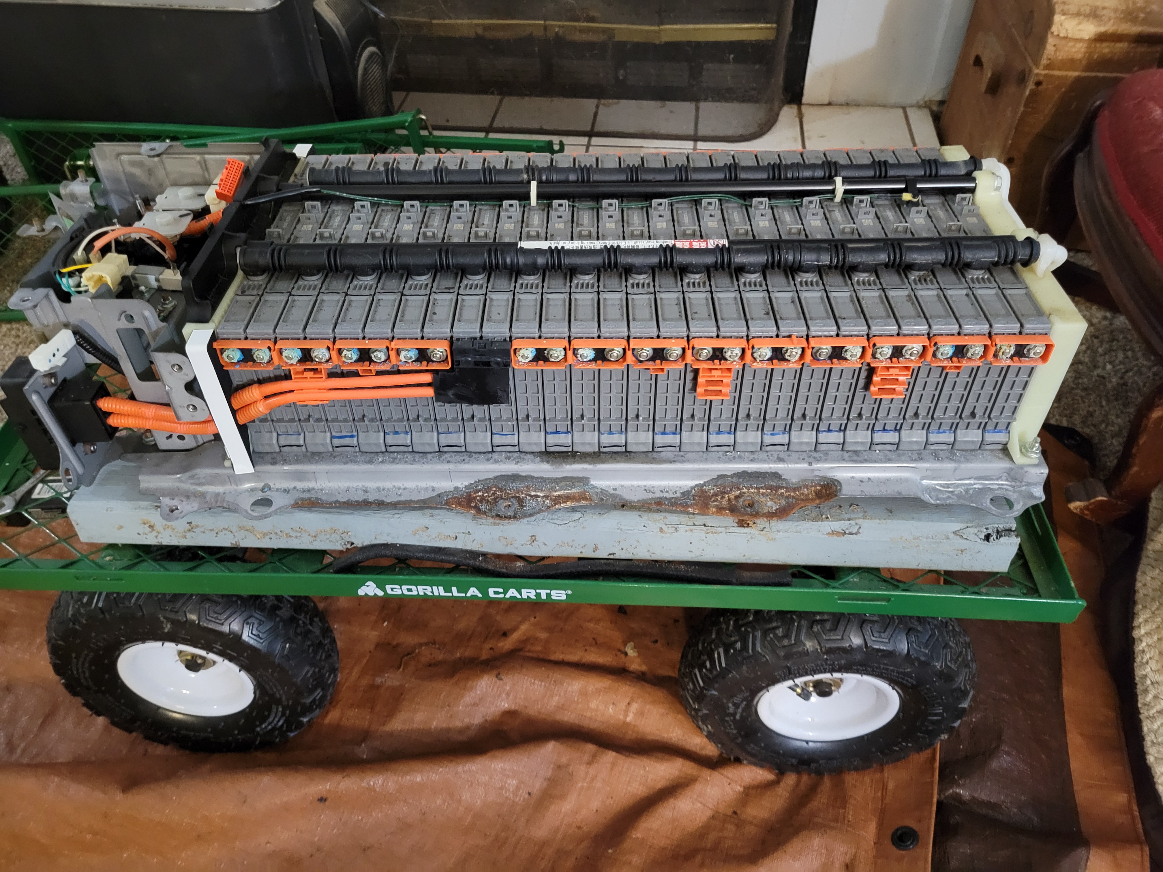

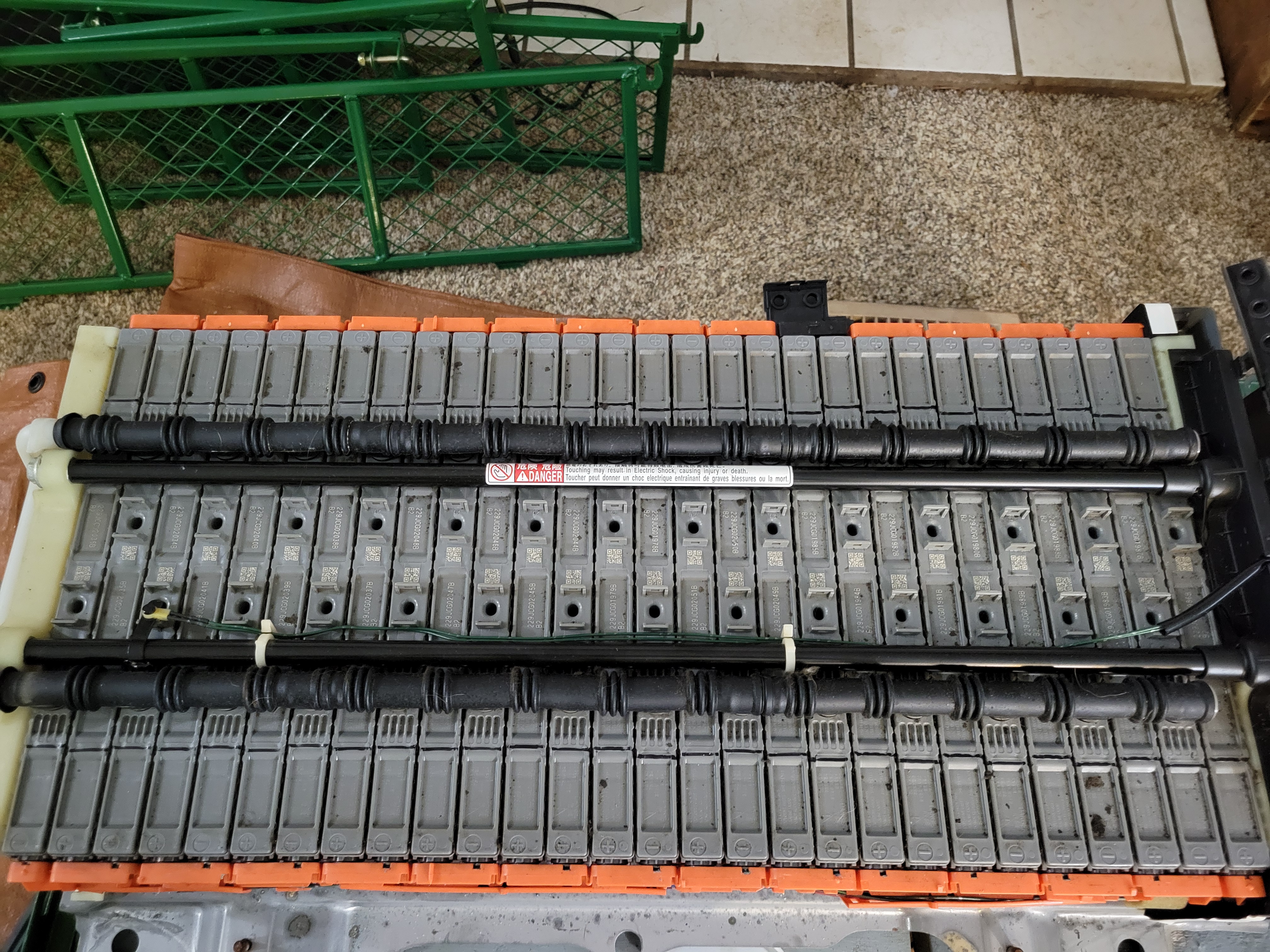

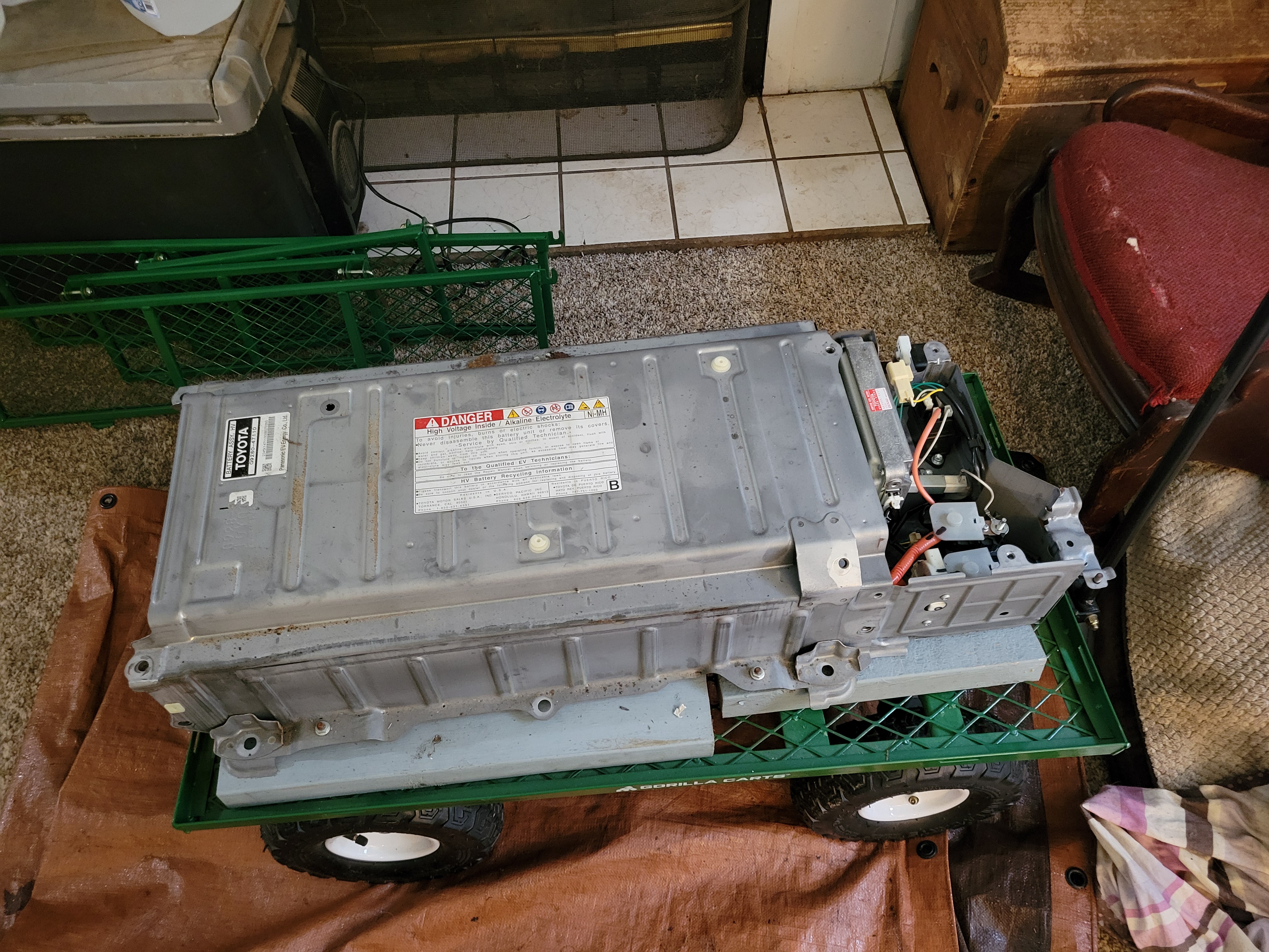

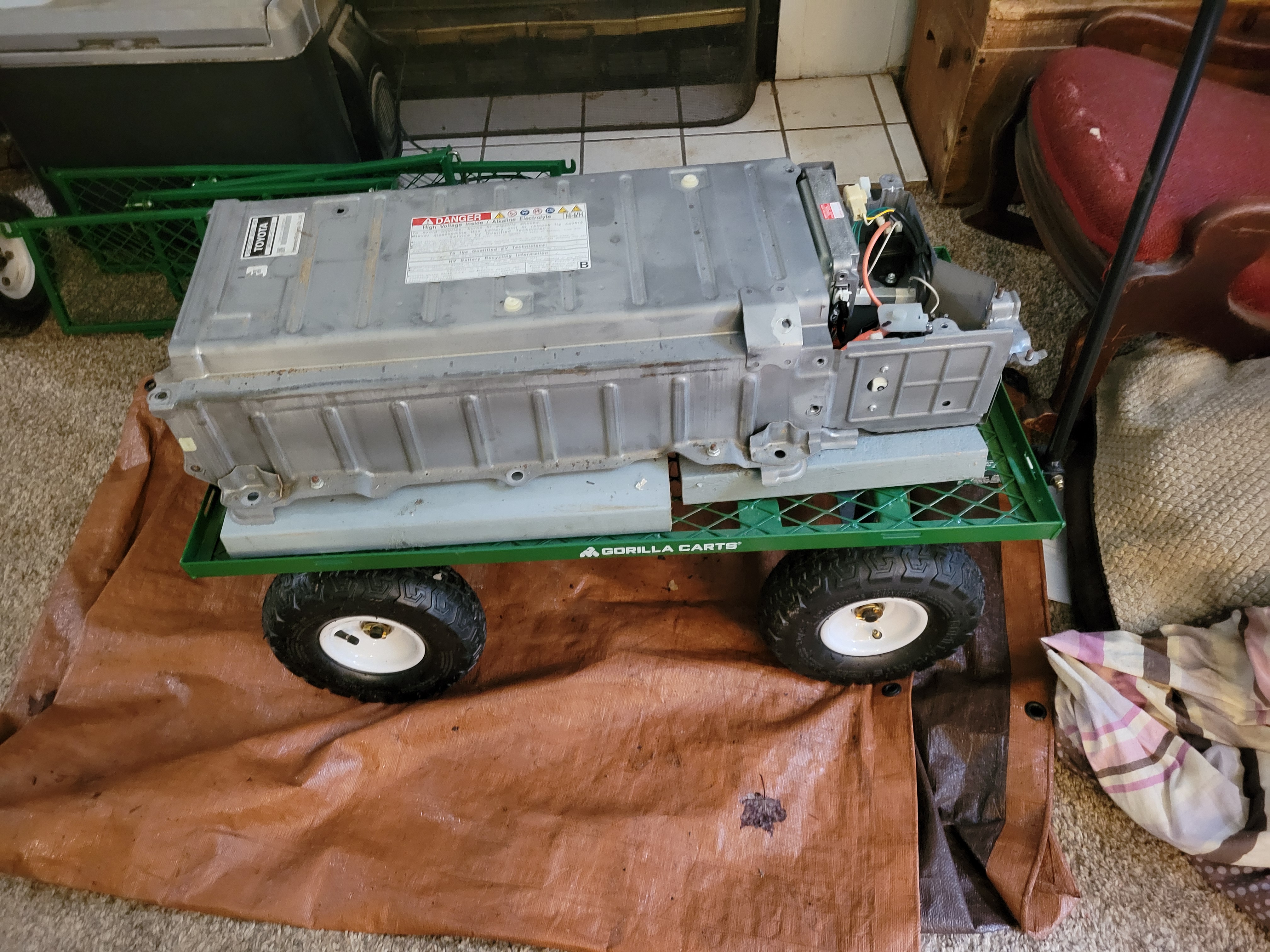

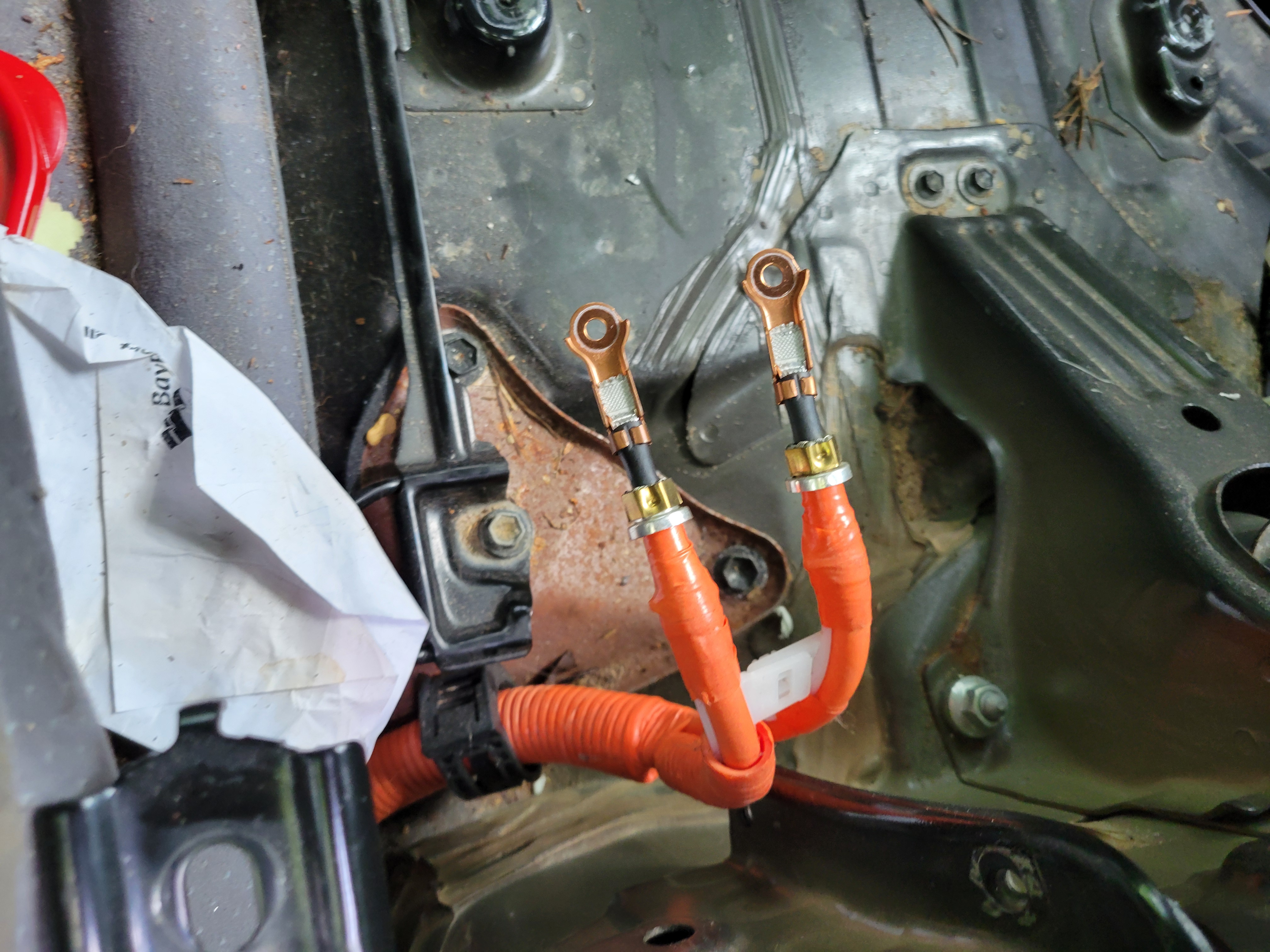

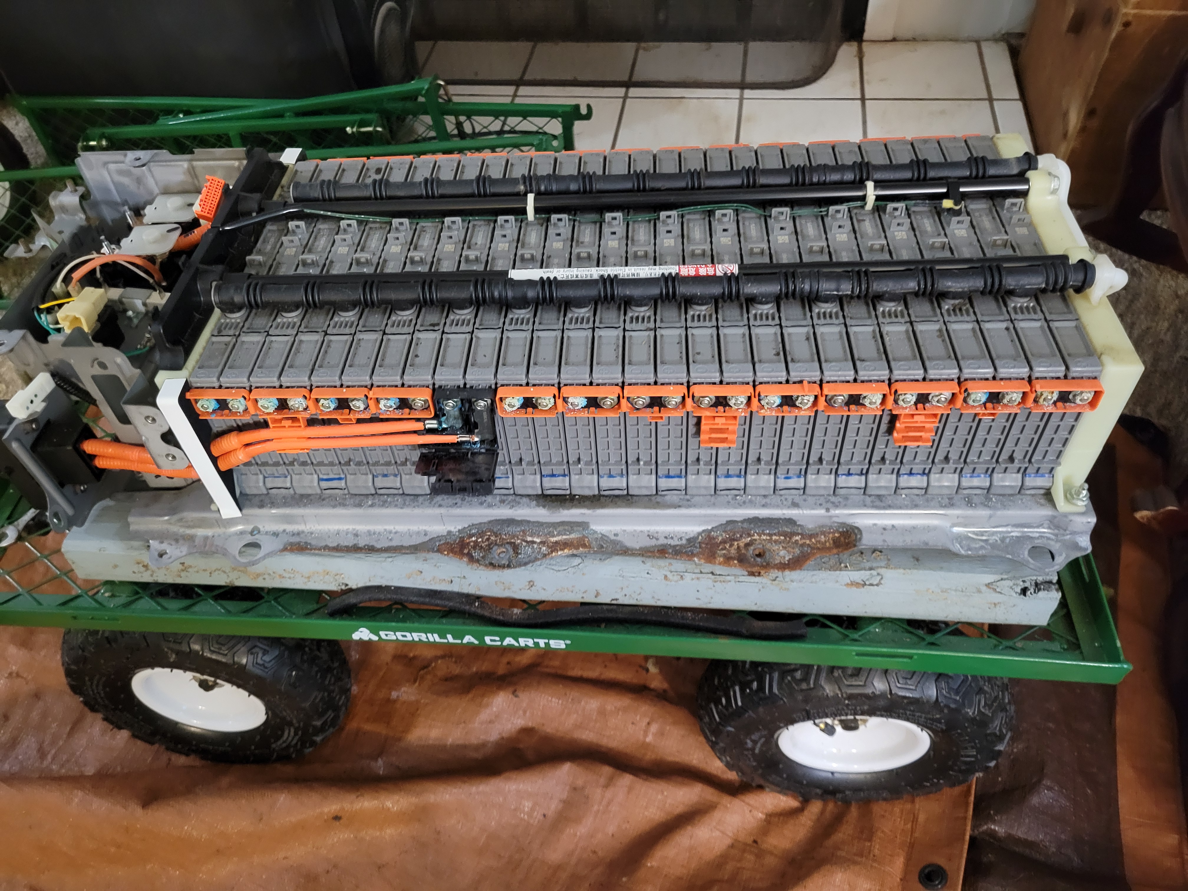

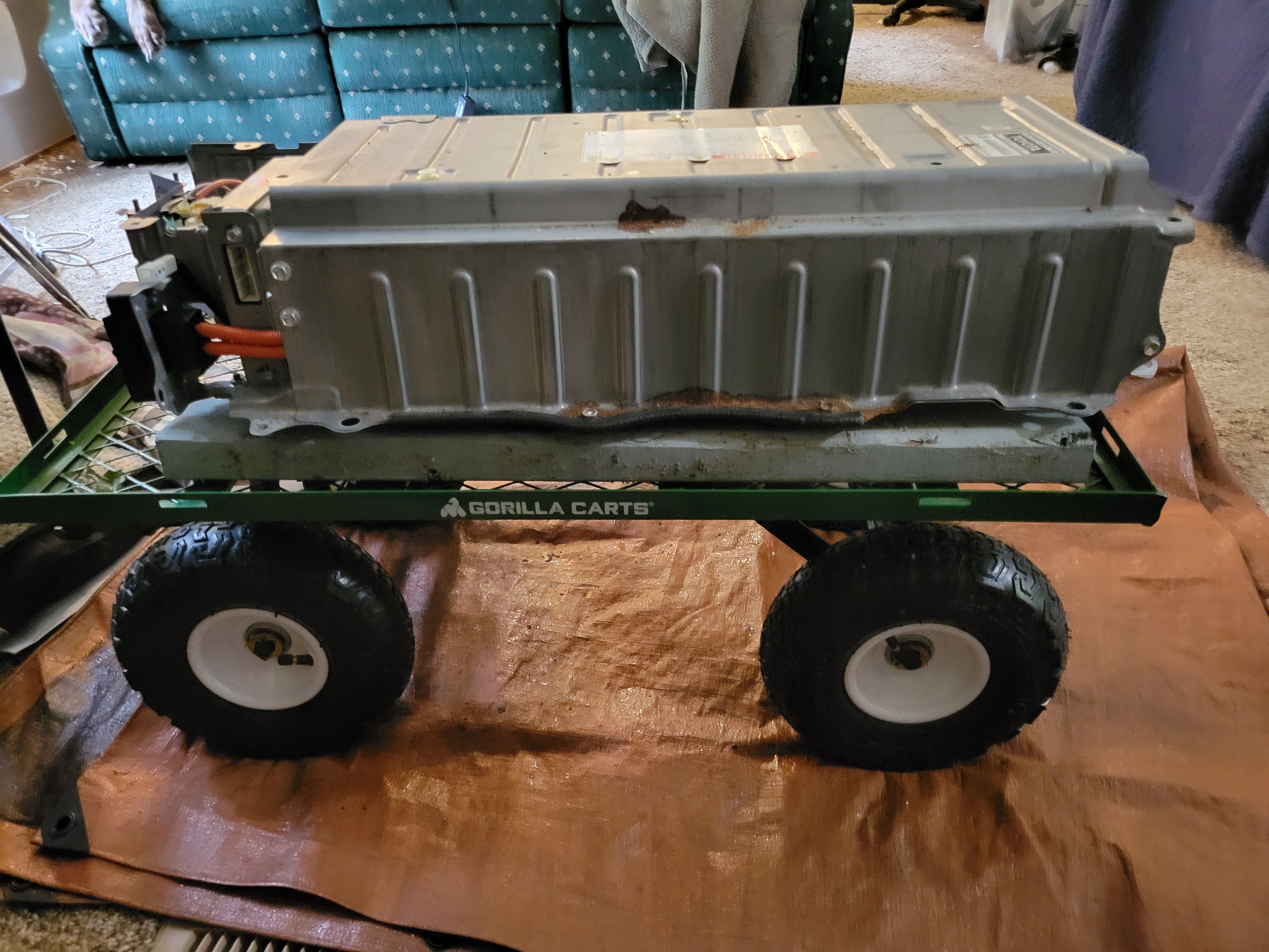

    A lot of pictures incoming
    Video
    1. What is the next step here?
    2. Does the resistance test on the individual cells where I test from the post to the metal chassis work? I know I have to remove the bolts and the plates between cells.

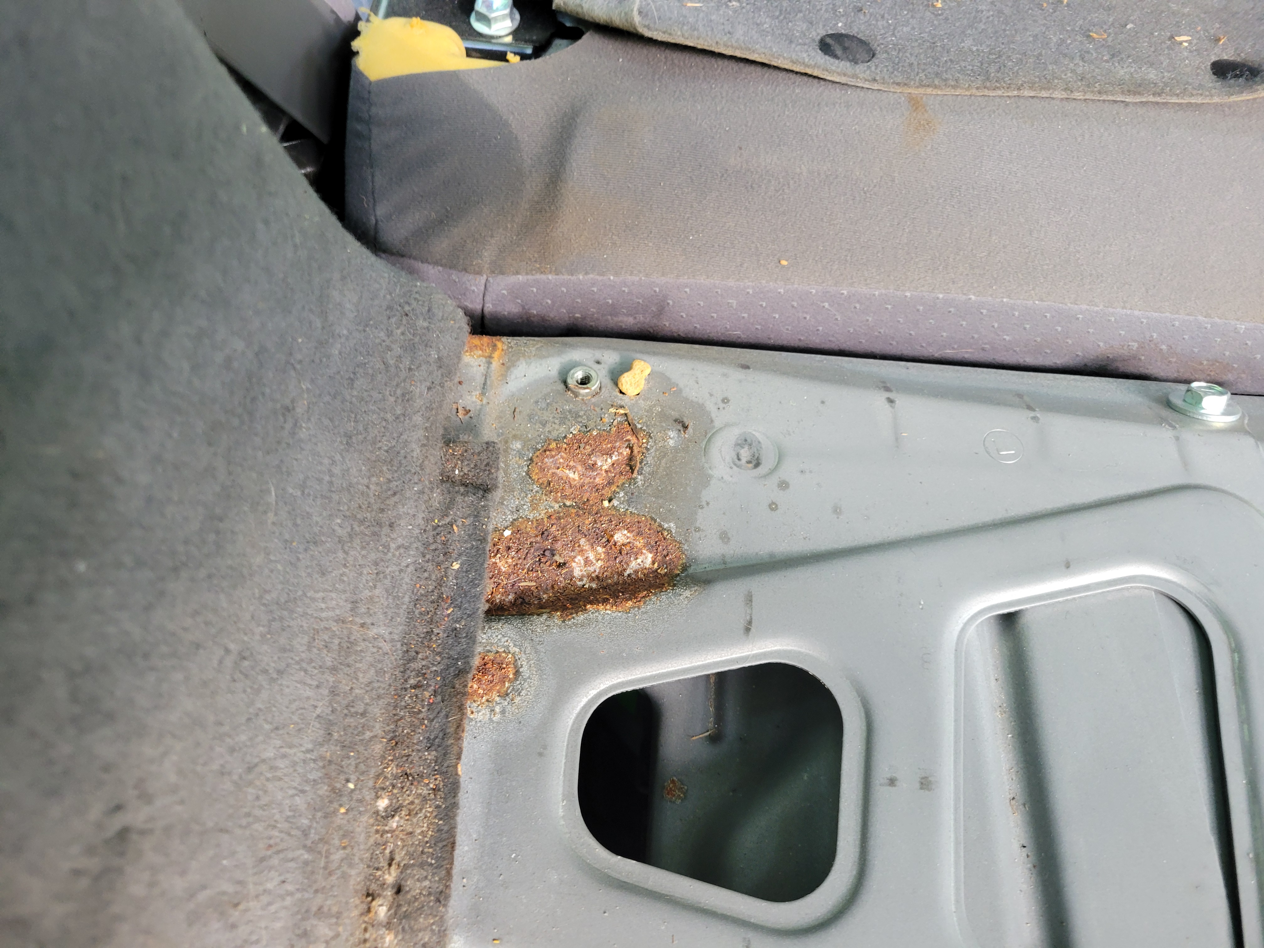

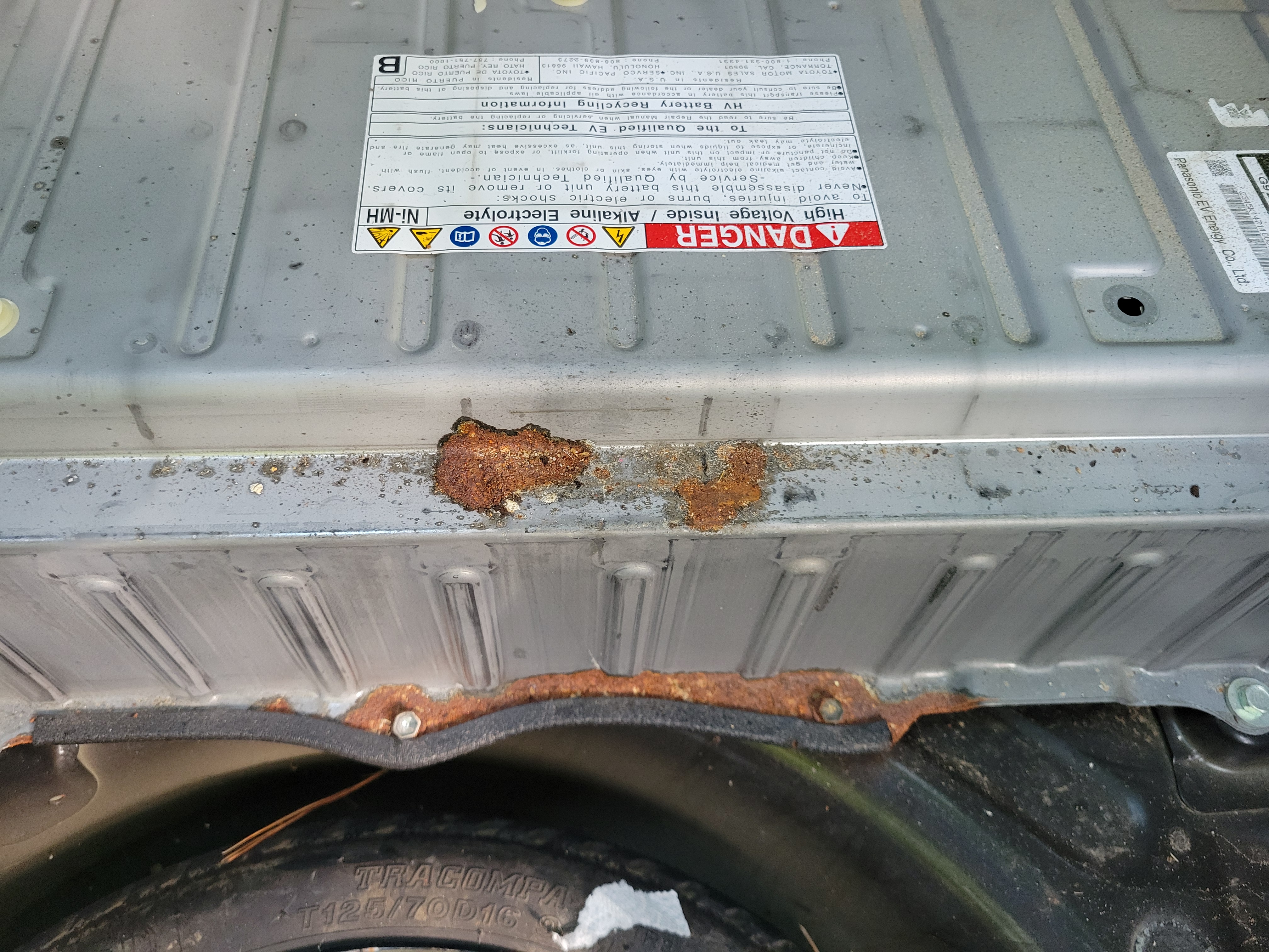

    I just noticed something myself. Staining on the metal right under the cells from cells 11 to 15 going from the right.
    Is that what I am looking for?
  17. mr_guy_mann
    mr_guy_mann Senior Member
    Sep 3, 2020
    4,111
    2,011
    NJ-USA
    Certainly suspicious.
    Set your digital multimeter to DC volts (if yours has manual range setting, go with 2.0V).
    Put one lead on one of the battery module studs, and the other on the sheet metal base. Ideally you should read 0.0V.
    If there is any voltage, even 0.01V, then that module either leaking or is connected to one that is.
    Carefully remove the nuts and bus bars and recheck. (this isolates blocks from each other, eventually you will have the individual module(s) that are leaking).
    If-once you find the problem, then you get to do research on how to fix it. "Just" replacing failed modules is cheap but is only occasionally successful.
    Charge - discharge cycling modules takes more equipment, time, and knowledge. There's grid chargers that cycle the entire pack vs RC hobby chargers that do individual modules. Do it right and you can get a few years out of it. Do it wrong and it won't work at all.
    Then there's "refurbished" packs (either of the above processes done by someone else, with the same possible outcomes).
    Or getting a new pack - such as from Toyota. Should last 10 + years.
    There's many days of threads to read about all of this.
  18. Carall
    Carall Active Member
    Apr 22, 2023
    316
    104
    Harrisonburg, VA
    What I see is the battery at the end of its life.
    If you replace the leaking module, the next leaking one will appear again.
    I was able to find which one was leaking only when the battery was warm, having just been removed from the car.
    Unscrew all 56 nuts and remove the bus bars off the modules. Then set your multimeter to the continuity mode and hook one lead to the battery case and with the second lead touch the module terminals one by one on the left and on the right side.
    The leak in the photo is visible in blocks 8 and 9.
