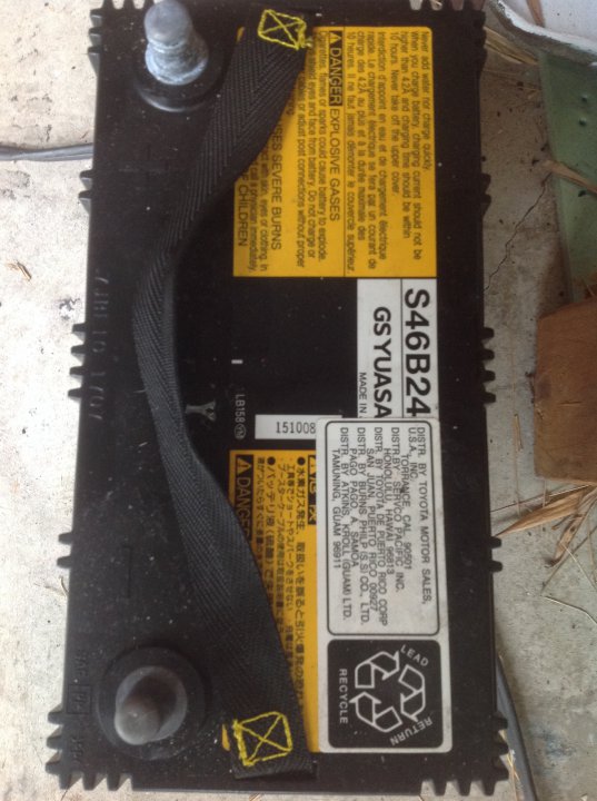

    I'm sure I can find the answer to this question on line or in the forums, but off hand, anyone know if there is a way to determine the age of the YUASA battery I removed? Could really care less how old it is for the purposes of this thread, but hypothetically, if the old battery is only 1 year old and hypothetically, if my replacement battery were to fail after one year, I'd like to be aware that I have a BIGGER problem than just a dead battery.

    There is a date stamp code on the top of the Yuasa battery in the order of DD/MM/YY.

    If the battery says YUASA on it, it's probably original. A replacement from Toyota would say "True Start"

    So October 15, 2008. Almost 6 years old. What a surprise that the Toyota dealer who sold the car used, to the person from whom I bought it (a good friend, so I know he's not lying to me), told him a little over a year ago, that there was a BRAND NEW battery in it.
