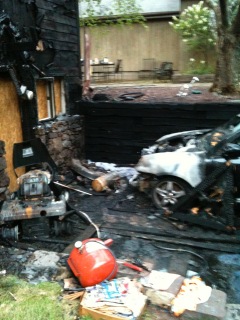

    Not the best picture .. this is mine. It happened over two years ago and I just settled the house claim. Cars were only a couple of weeks.

    However, judging from the pictures/video the engine and not the hybrid part was the fire source. I guess AC is a possibility too.

    Just a quick update, fire investigator which was hired by my homeowner insurance came out and took bunch of photos but didn't say much on how & what. They have given the ok to tow the vehicle away by my auto insurance company. Since it is Friday, they said it might be on Monday at the earliest to tow it away. Homeowner insurance company requested that car to be owned, wrapped and preserve it. Toyota stated that someone will be in contact me within 24 business hours but no contact from them. I took 3 days off work to deal with fire restoration company, contractors, insurance company reps. I just want quick resolution so I can move on.
