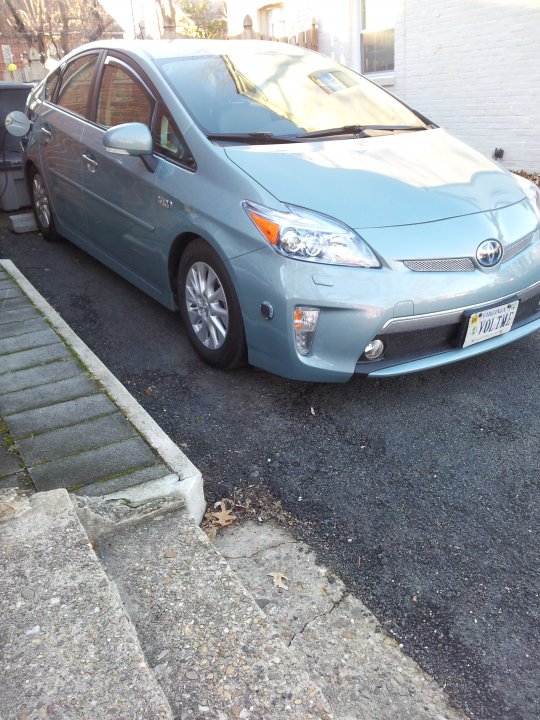

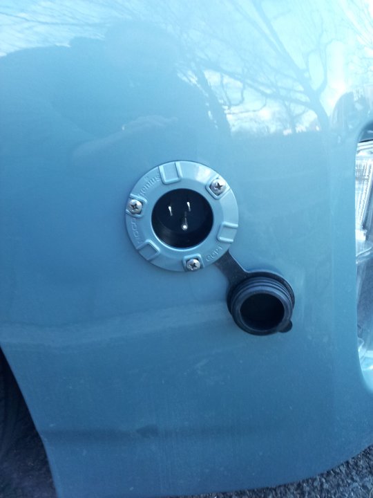

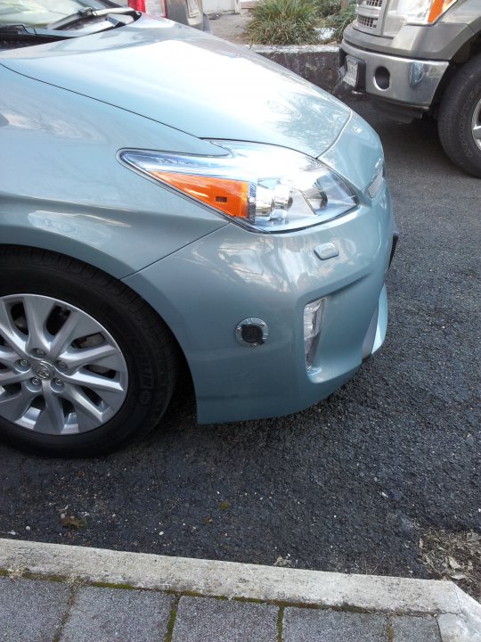

    My solution: after buying a NOCO Genius 120V extension port suggested by someone on Prius Chat, I had it painted to match the car (pennies really) and then mounted it on the front corner of the bumper, right next to the windshield washer fluid tank. This location is also a good visual reminder to unplug - more noticeable than the OEM black plug hangin' off the black grille. Note: my wall receptacle is on the same side of the car as this NOCO port, the way I park, and immediately by the front patio stairs.
    The NOCO mount is painted. The rubber cap for the plug well is black, as it flexes too much to hold paint IMHO.
    I also replaced the OEM plug on the Engine Block heater with a solid aftermarket plug, then sealed the cord and pugged it into the NOCO Extension.
    For safety with a potential arc fault secured the single-receptacle circuit at the panel with a "CAFIC" or a "Circuit Breaker and Combination Arc Fault Circuit Interrupter".
    Why I use the EBH - fast heat on those Winter mornings. My normal commute is too long for exclusive EV power no matter what, so I might as well fire up the gasoline engine at first.
    NOCO Genius AC Port Plug with integrated Extension Cable GCP1.jpg NOCO 120V plug install - 1.jpg NOCO 120V plug for Engine Block heater.jpg Engine Block heater plug - mounted.jpg Combined Ground Fault and Arc Fault breaker.jpg
