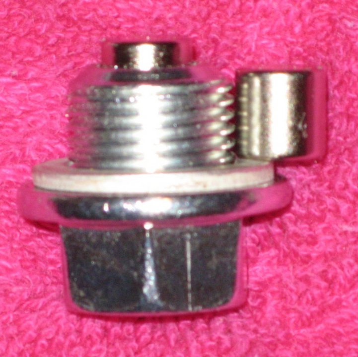

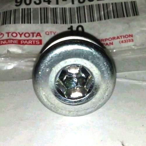

    The ecu inverter drain plug is located on the bottom of the transaxle. On the Gen III's, it is the same 10mm socket hex as the transaxle fluid drain plugs.

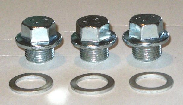

    I made up several kits that replaces the plugs with a much easier to use hex head with a complete set of washers.
    I am posting photos of the OEM plug and my kit which includes a rare earth neodymium magnet transaxle drain plug and two other plugs with the aluminum gasket washers.
