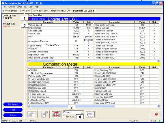

    I normally use the Car Scanner phone app and a $35 Bluetooth obd2 interface for quick monitoring without a Techstream PC and hardwired obd2 interface. The pic above was from that phone app.
    On Techstream you pick Engine and select Data List. Right click on "Coolant Temp" and move it to the top if desired.
    You then pick Combination Meter and its Data List. The Combination Meter's
    "Coolant Temperature" is the second coolant sensor and is downstream of the Exhaust Heat Recircation System on a hose near the egr.
    Normally they will be with a few degrees of each when warmed up.
    Its possible to select Dual Data List and see both on the same screen.
    Generic Marked Up Dual List
    Note the Engine ECU temp sensor is listed as "Coolant Temp" while the sensor downstream of the Exhaust Heat Recirc will be spelled "Coolant Temperature"
    Techstream Basics part 2 attached

    I ordered a Bluetooth obd2 interface last night. I got one a while back that didn't work. This time I ordered [the primary] one that the Dr. Prius app developer recommends.
    I never knew about the Dual Data List. Thanks for that and the Techstream Basics pdf.
